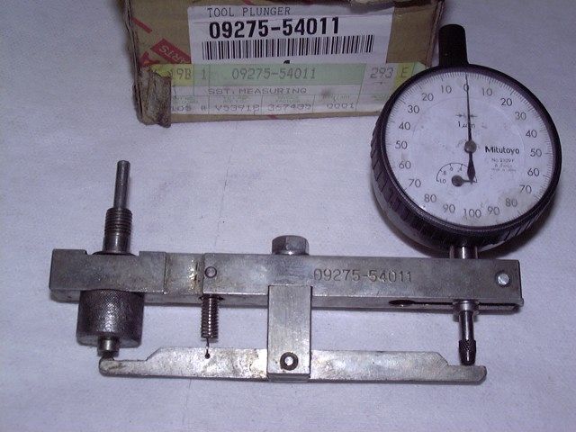

Injectorod's given a good description. You could trial a few positions and see how performance changes and go by feel (like setting petrol ignition timing by ear) or another way of doing it that may get past injector pipes easier (has one like this in TD service manual
You can get small DTI gauges with a diameter about the size of a 2 dollar coin which can be fitted without taking the injector pipes off. Probably not cheap tho -and they need to read in 1/100th mm so quite delicate.
