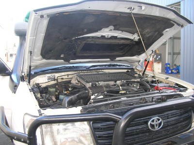

1HDT + turbo upgrade + FMIC + Big Bore + Water & meth injection depending on how much boost you run can put you over 600Nm
or if you want to spend more money you could do the same on a transplanted 1HDFTE + chip it and you should be around 700Nm.

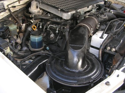

Basically after more power for towing. Iv'e got the 1HDT engine. Boosted to 13psi. Its always a juggle between keeping EGTs down and Trans temp down. I find on hill climbs towing 3.5 T I end up in first gear to keep temps down. Or in low range. What could I do as far as turbo upgrade goes and what would I achieve.

Has it ever been on a dyno? if so what did it make?
You need to cool the intake air down. That is the first thing you NEED to do. it will drop your engine temp, your exhaust temp and put some long term reliability into your set up
Change your turbo to something that isn't heating the air so much at 15psi, and spray 5-600mls a minute of 1/3 methanol 2/3 water down its throat, enjoy the extra power and watch the temps drop back into the safe zone
