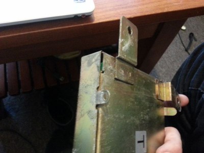

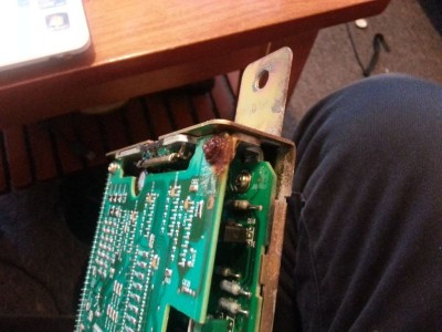

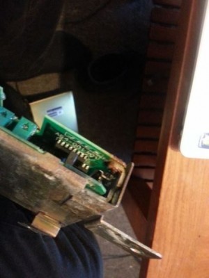

ok, found the Transmission control unit, its right behind the the driver side rear speaker. Very strange location.
Anyway, I definetly think it could be the culprit, the box had visible corrosion in one corner, and one a few drops of water came out of that corner whilst I was undoing the case. Got a new one coming up, hopefully monday! Take a look and see what you think...

Its not a bad place to keep it in my opinion, keeps it out of the water (aslong as you have no leaks....)
