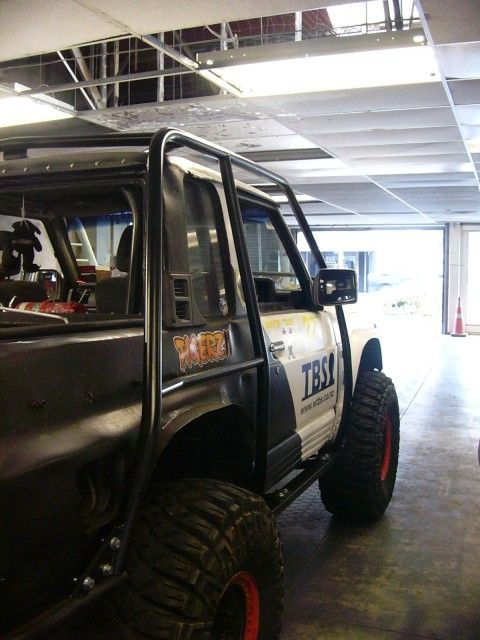

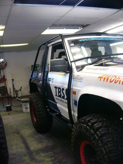

this happened over last couple a weeks and finished today...roll on manuku winch comp just ground anchor mount to be done.....

what about some front guard protection :?:
Re: My GQ Build .........
did you run out of black pipe :lol: :lol:

skid wrote:did you run out of black pipe :lol: :lol:
great that you can get different coloured tube dude.... :lol:

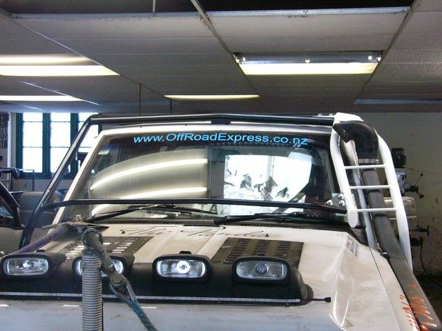

Post by taz01 »

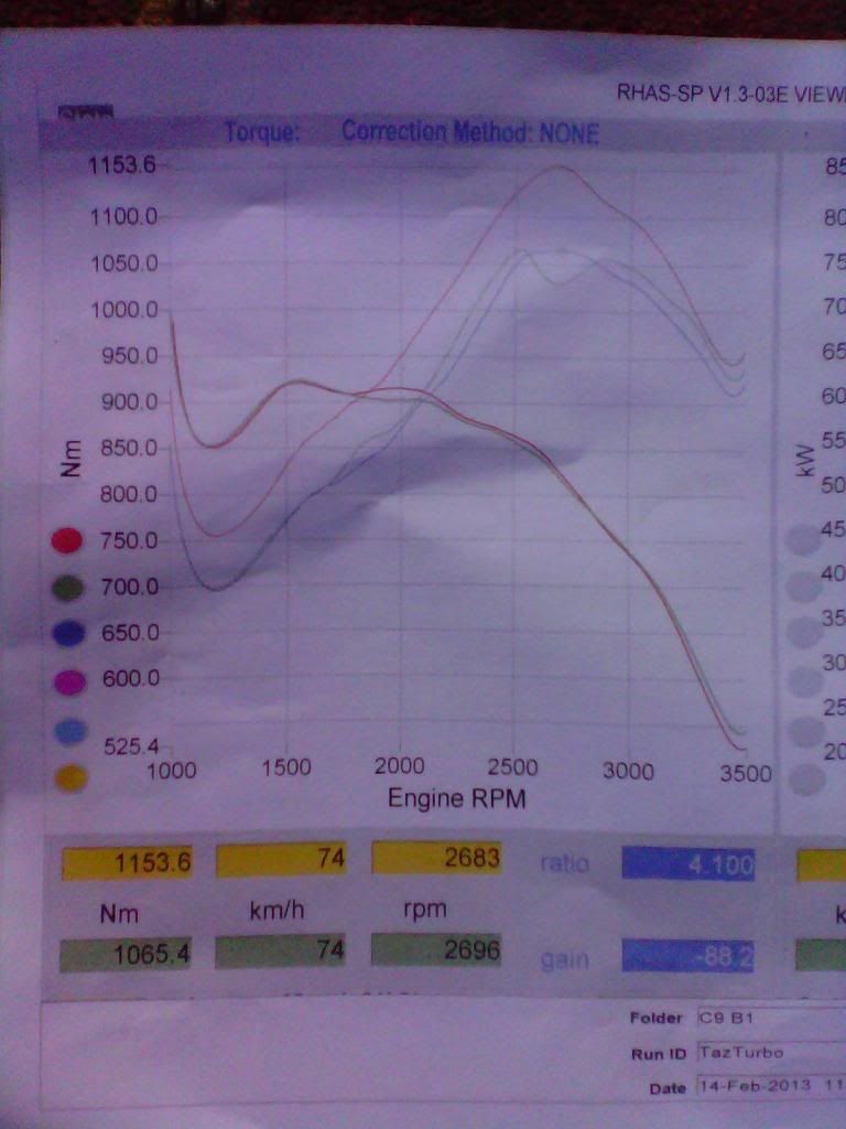

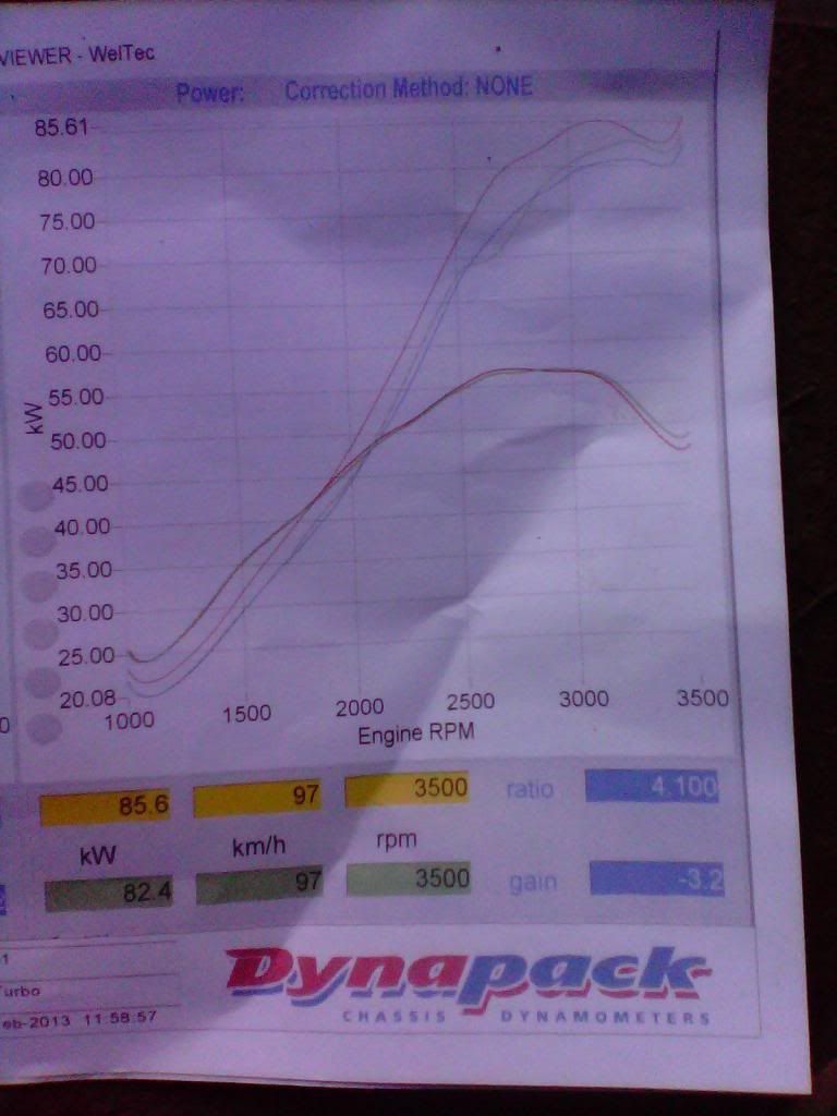

Dyno'd the Panda today not as great as id hoped but compared to a std nonturbo bloody good..........
Torque: std - 920Nm @1600rpm
Panda - 1153.6Nm @2683rpm
Power: std - 57kW @ 2600rpm =76.40 Hp
Panda - 85kW @3500rpm =114.74 Hp
These specs are at the wheel im told add 30% to get engine results so 149.162Hp
1499.68Nm

suzolla
Posts: 1577
Joined: Mon Jun 13, 2005 12:00 pm
Post by suzolla »
Hi Taz,
There is something wrong with some of the figures.
920Nm @1600rpm = 154 kW
1153.6Nm @2683rpm = 324kW
57kW @ 2600rpm = 209 Nm
85kW @3500rpm = 231 Nm
Power values are possibly right but seem a bit low.
Torque figures must be wrong, perhaps not taken gearing into account
Tim
turoa
Pyro Junior
Posts: 3112
Post by turoa »
There is no torque loss through the drivetrain and it sounds like it isn't divided by the gear ratio, so 1153.6/4.1 (assumed diff ratio unless its been lowered) = 281.37nm at the fly :wink:
Sounds like you need to get a turbo pump built for your truck :mrgreen:
taz01
Tazzles
Posts: 1644
Location: Lower Hutt
Post by taz01 »
not sure about the figures only reading from graphs handed to me and yep says 4.1 ratio using 4th gear
Blue lines my 2 runs
lower lines are non turbo
