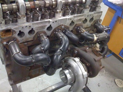

Does anyone have Ideas or a manifold around they want to sell? Is the L20et manifold no good, some say number 6 gets farking hot and melts? Am I best to try and make one up? cheers

Here is one I built years ago

wow wax that's unreal! care to knock up another one just like it lol! how did the LD go with that? what turbo did you use? :D

for a diesel i would stick to a log style. it would perform better and drive ability will be substantially better.
plus its easier and cheaper to make.
look at the TD42 guys, none of the top guys run tuned manifolds.
leave the tuned style for high end petrols.

Your right. This was a petrol one.
The engine made great power was a massive effort making it. I spent heaps of time making it look complicated just for the cool factor
