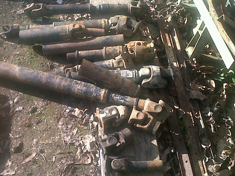

unsure what they have come off? just went to the communal pile of drive shaftes that we have stored for conversions.
any way of identifying them?

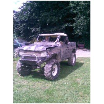

Got any pics of the truck as it sits now?
Didn't barbie drive a jeep??

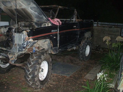

re-pulled diff out last wekend and re-cut the brackets off the diff, even rolling the diff wont be a feasible option, i will stuff my steering up if it rolls too much and it needed to go alot, its just sitting on a lifting frame off the diff at the moment, il sort the shaft and then weld the brackets back on.

forgot to say its just a river / mud pig....

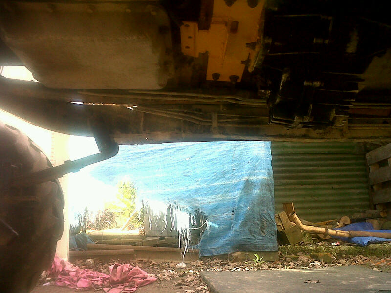

Hi De-ranged,

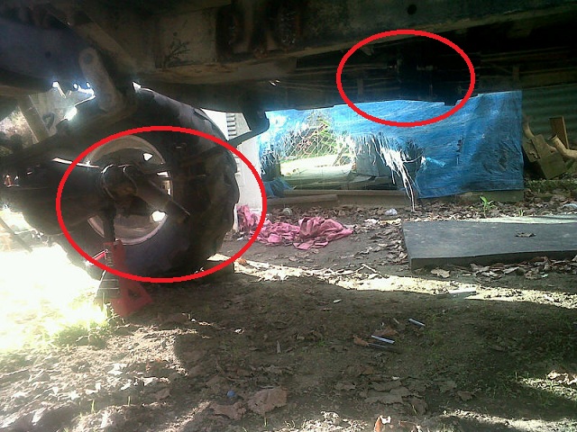

here is what im trying to achieve in the pictures, i got 4 kids and a morgage so trying every option to cost no money. any help or direction appreciated..
the one i already made but you can see the knuckles very tight, so was going to try the one under it, the pic shows a rough angle of what i needed.

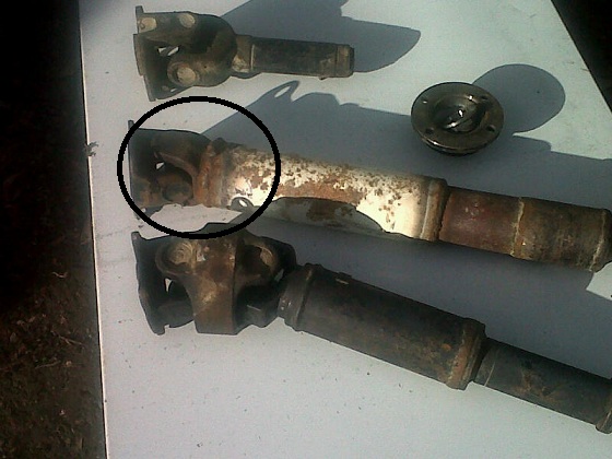

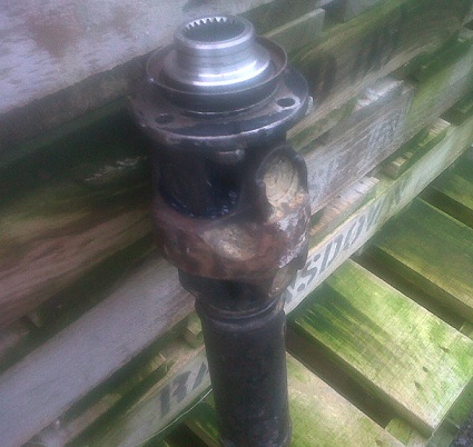

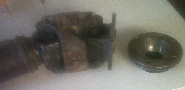

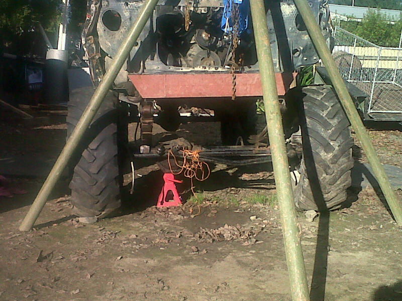

couple more pics
are any of these spears usable?

Dont know what your original shaft is from I'd say a car from how tight the UJ"s are,
Looking at the angle the shaft at rest, and you'll need even more at drop I think the single UJ is a better option
Try the double carden joint just in case, jack the front of the truck up to full suspension travel and vice grip the double carden joint onto the transfer case drive flange and just see if it will angle down to the diff, it may do its hard to tell from the pics
If it dosent then I'd look at using the big drive shaft in your parts pic (the long one with the expanded tube) measure the crushed ends of the tube where it is welded to the UJ's/slip joint, it should match the dia of the length of tube you have near the top of the pic, theres your drive shaft bits
If that dosen't work head down to the local engineer and get a bit of pipe machined to the length you need so it will slip over the cast pieces of that long drive shaft
All else fails, next time I go down to see Wingnut I can nip in and have a look, take some measurements and sort the problem

cheers for the quick repy, my mate made that drive shaft with the circle around the original transfer case nuckle, the shaft is made from a sleeve on a sleeve on sleeve (back yard style i know but...)
That double cardon looks like it gets more angle than my orginal so will try clamping it in place and turning to see if it binds.
The trucks at full hight at the front as the purches are just sitting there as may have to slighlty roll diff aswell.
