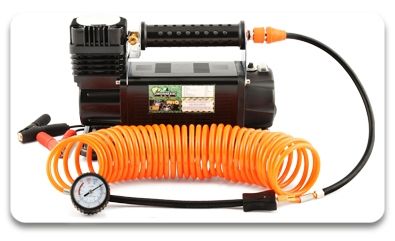

With my older 80 I was going to sort out an air tank for my Ironman FlowPro Max compressor. This one below.
I was going to run a truck horn off it. 8)

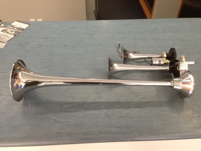

They look simple.
Ahhh. It looks like I'll have to go with a compressor after all.
I've already got this collected so far.
I'd like to have the compressor mounted in the rear but still portable. And mount the air tank under the rear where the spare wheel can mount. I've got plenty of piping and fittings. I need a PRV fitted to the tank and an electric cut off solenoid gizmo to switch the compressor off once it reaches desired pressure.

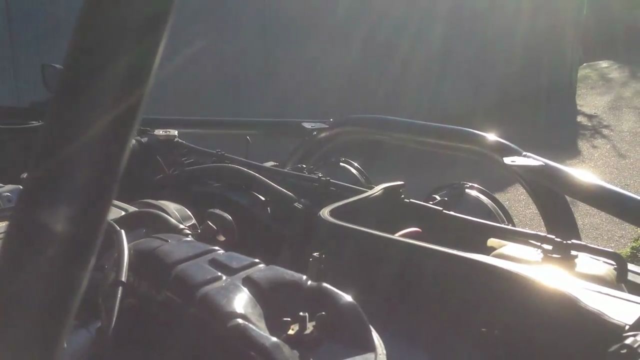

How pathetic is this for a stock standard horn on the 80. :lol:
The one on my motorbike sounds more intimidating. :lol:

Got all the parts together and working today. Fit it tomorrow. 8)
I've got it setup so I can unplug the 45amp power wire from the truck and plug in the extension lead to the aligator clips, meaning I can still use the portable compressor for what I brought it for. I can also unplug the pressure regulating switch from it too.
Had the pressure set at just 50psi and those horns might not look much, but man, they do the job. :shock:

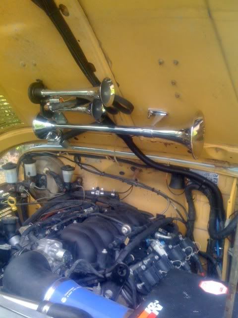

How my old FJ40 looked under the bonnet.
I loved it that much that I had to do the same to the 80.
