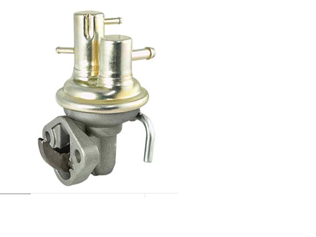

http://suzistore.com.au/onlinestore/four-wheel-drives/lj-4x4/lj-4x4-lj80/fuel1956900166/PUMP-KIT-FUEL-2424-detail.html
this I the kit I used . suits the muikini factory pump.
you should just be able to undo the bolts around the perimeter and the pump comes apart .
3.5Pajero
Posts: 92
Joined: Fri Nov 19, 2010 8:42 am
Re: Oil…oil…everywhere - Story of a Bleeding Samurai
Post by 3.5Pajero »
Bugger yeah my one looks like this..I guess the ones with the ring of bolts was from a time before we just threw things away?
