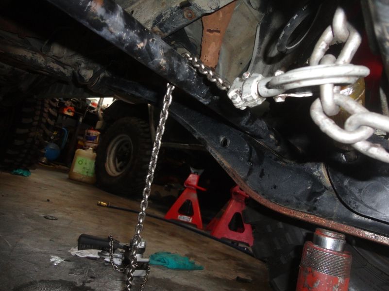

Ok i need some help/advice guys please
Ive brought 5inch suspension lift for my lc80(springs,shocks,panhards,caster correction plates to suit)
And today have come across the tie rod/radius arm issue :cry:
Radius arm is hitting steering just trying to line up caster brackets and its looking like im going to have to grind to much off radius arm for it to be safe.
Because springs are new at the moment its probably sitting around 6.5 to 7 inches higher than it was and hasnt settled yet,if that makes any differance?Image
What i need help with is my options with getting it sorted and what its likely going to cost'
Havnt really got spare cash to go with custom setup
Would using caster correction bushes help with clearance over plates?
Want to make sure my next move wont be a waste of my time and money.
Thanks.

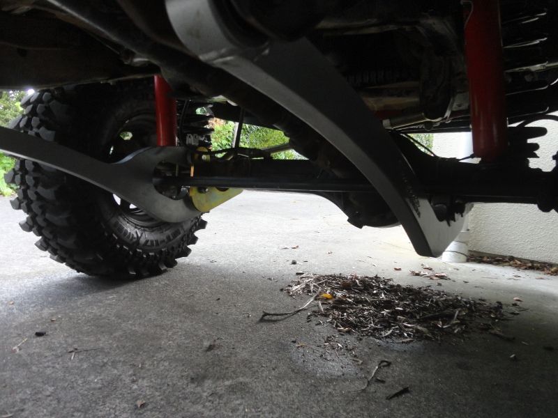

My trucks manual,have to look at getting something made up
Lchundy
Posts: 415
Re: Need advice on 80 suspension lift
Post by Lchundy »
Got heaps of clearance now 8)

Those Superior Engineering super flex arms?
Where did you get them and how much?
I too have castor plates but haven't fitted them because of the steering rod clearance issue.
Just trying to way up the options.
Lchundy
Posts: 415
Post by Lchundy »
Yeah man
http://www.4wdbits.co.nz/ProductDetails ... uctID=4631
You can order them to suit your lift,just takes ages to get shipped here.
Castor plates still cleared but not by muchy
