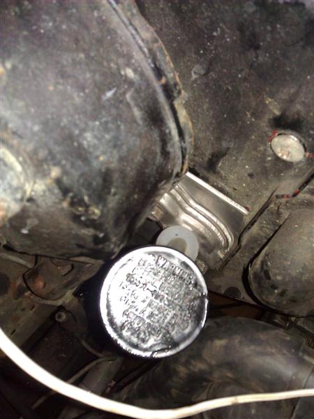

Internal baffle plate and drain plug. Have i done this right ???? Any thoughts would be appreciated

Re: Suzuki+SR20DET+Hilux Axels+coils+Exo Cage
That Baffle will work fine for keeping the oil around the pick up, the other reason for baffles and windage trays is to keep the crankshaft out of the oil, I don't know if this is a problem in your application. Keep up the good work and thanks for sharing.
