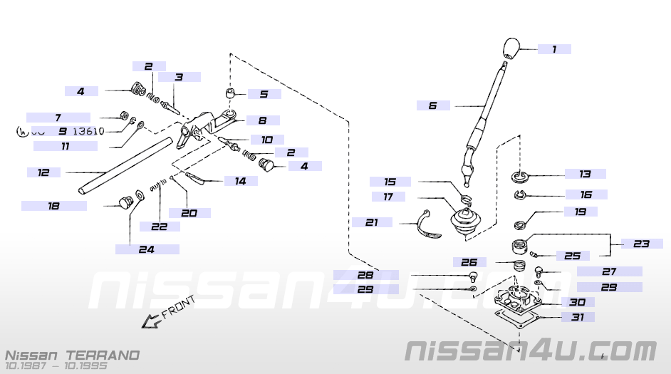

Crash bandicoot
Posts: 2924
Location: Towing a hilux
Re: Gear problem with '93 2.7TD Terrano
Post by Crash bandicoot »
nzshred wrote:Straight up just remove the stick covers and pull the gear stick up? Then what? stick it back in?
The gear stick is still moving fine and I can put it in and out of gears.
http://static.nissan4u.com/epc_img/14541241484407.png
then undo the four bolts holding part number 30 in place. you'll be able to see the linkages.
