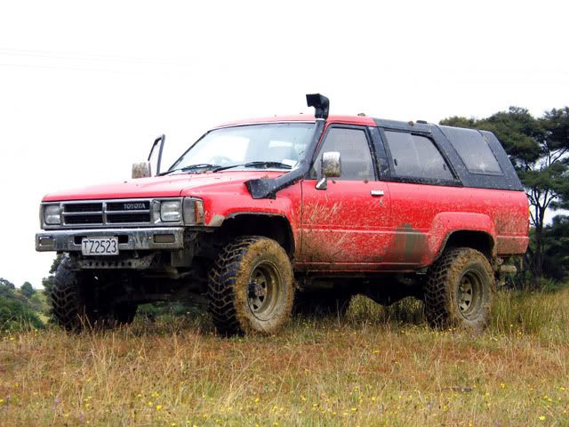

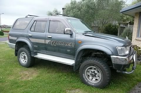

My guess.
you have a 2 door surf body with a fibreglass roof like this
or a 4 door body like this
Sitting on a solid axle surf chassis? Chassis number should start LN60 or Yn60
