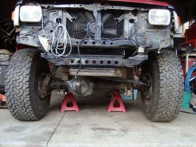

I've recently put a 350 in my Hilux and have been slowly working out the bugs and am almost done with all the teething issues HOWEVER... on the weekend we took it up the bush and had a bit of a play since id finally finished the bump stops but early on the temp popped up and had me a little worried. it jumped up to about 105 deg so nothing to dangerous but not very comforting as i wasn't really giving it shit because the new engine isn't run in yet...
Details
New 350chev
Its in a ln60 body with a 50mm body lift
Brand new 60mm alloy radiator (bolt in replacement of factory one)
New 82deg thermostat
Two new 10inch high flow electric fans, (hardwired constantly on)
yea so if you guys with v8 hiluxs could share how you keep your cool or any one with helpful info or ideas,
all input is appreciated
Details
New 350chev

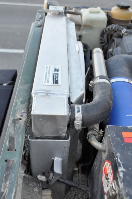

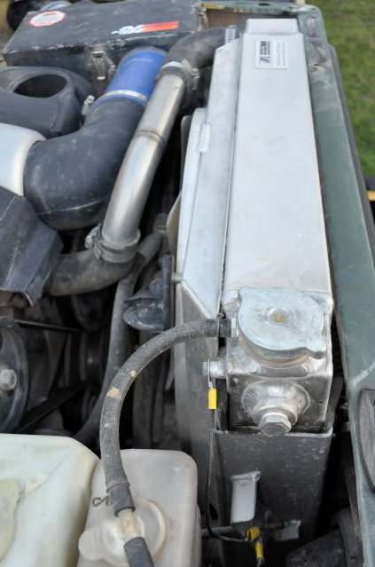

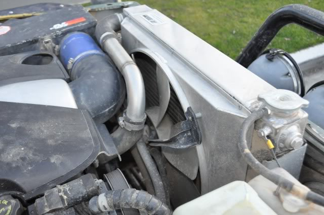

similar issues with mine in a 130 series surf.body lifted etc.running a v6 model radiator,biggest i could buy at the time and when i was running the stock 2l motor.once v8 went in added 12 or maybe 14inch davies craig fan on auto/manual switch.got alot better but still had hot times so then added 4l stainless water tank between motor and rad for extra capacity in the system and that fixed it all
Re: How to keep a 350CHEV cool in a Hilux???
muddyhilux wrote:similar issues with mine in a 130 series surf.body lifted etc.running a v6 model radiator,biggest i could buy at the time and when i was running the stock 2l motor.once v8 went in added 12 or maybe 14inch davies craig fan on auto/manual switch.got alot better but still had hot times so then added 4l stainless water tank between motor and rad for extra capacity in the system and that fixed it all
Cant seem to open your images but yea that sounds like a good idea as i am pretty pressed for radiator space however i have plenty of room beside the engine for a tank, does it have like heat sink fins on it or does it just need that extra water?
ah yea pic loaded cheers.
does it not cop a bita shit down ther? and do ya think itl stil work if i had it mounted on the inner gaurd, inline in the top hose? (below the rad cap obviously)
