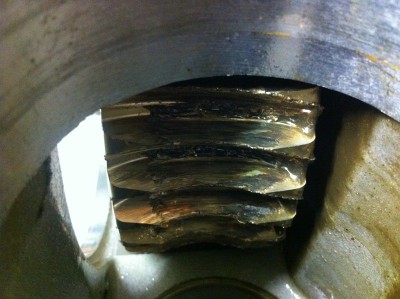

Anyone recently replaced the large worm bronze wheel.?
Suppliers or get 1 made?
Just stripped down my PTO for the first time, it would appear to me its fairly worn. A few searches seem to show that when it goes is damages the case - or am I ok to run it to death then replace.?
The smaller worm gear is fine.
Re: Where to buy Bronze wheel for Nissan PTO?
If that gear ends up stripping completely while you are hanging off a cliff somewhere out in the wops, then there is nothing acting as a brake within the winch to stop gravity taking you on a joyride to the bottom of the hill.
If that was mine, I would be replacing that before any more use.
Hate to say this, but that's the potential of a possible scenario. It will just effectively freespool.

That is also the wear and tear from not using the right oil.. Get some Elf sp680.. it is designed for wormgear drives.. and extreme pressure
Replace it ASAP. Keeping on using it will destroy the housing when it lets go.
Don't use any oil with EP additive, EP chews up the bronze wheel.
Try someone like monstr for a replacement, he just replaced his PTO with hydraulic.
yes - ive tracked down and got the right Oil
FYI - ELF no longer do 4lt packs - but Total do 4l "Carter EP680" which is the same as ELF SP680
Bronze Wheel -thanks for info- ill definitely replace then

First price to machine new bronze wheel and polish the steel wheel gear is $750 +gst. getting another 2 prices tomorrow but it aint looking cheap!!!!!
Could buy a whole runva, esp when I add in the $40 oil and $70 in bearing/seals.
I assume however that if I do the recon, the PTO with good oil should last very well and perform better than electric?

"Extreme Pressure (EP) Gear Oils
EP mineral gear oils are used more extensively in worm gears. Under conditions of high pressure and temperature, the EP (antiscuff) additive reacts with the metal surface to form a soft, slippery chemical layer which prevents severe wear and welding. Previously, there was a concern that sulfur-phosphorous EP additives would react with the bronze gear. However, new EP additive technology used by most of the major lubricant suppliers has reduced the corrosive attack by utilizing nonactive sulfur. EP lubricants work particularly well when shock loading occurs. EP gear oils also protect steel gears better than compounded gear oils."
The boys have run the carter oil for ages and have not observed any unusual wear other than pure abuse.

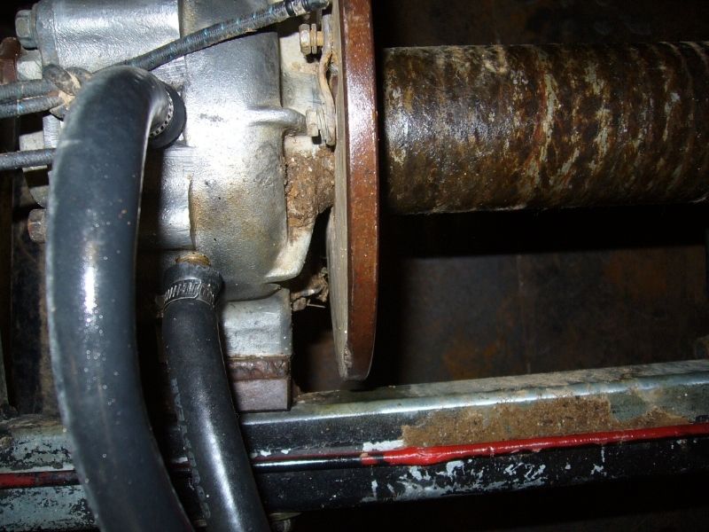

what he said,
Aaron (the yellow thing you will see on the weekend) has just replaced the breather in the top with a larger hose fitting and hose back to the external tank (above the oil level in the tank)...tank is not sealed it has a breather on top ...... and put another fitting straight into the housing a little further around the case as the oil feed
looking straight down on winch
Drive as fast as you can, NOT as fast as you can not.
