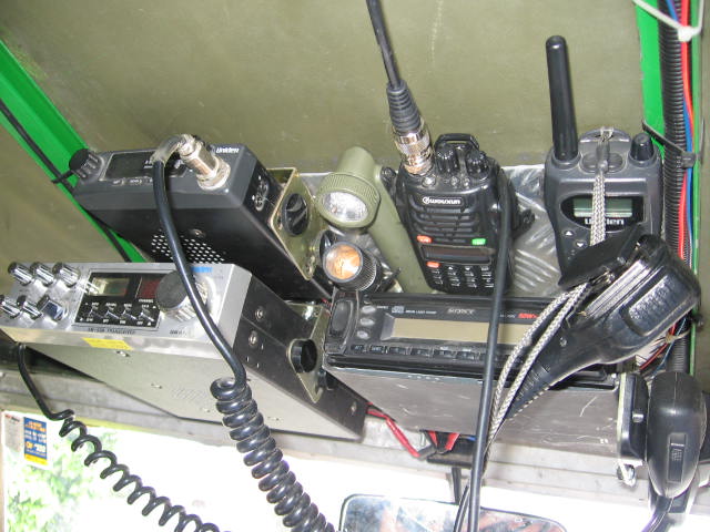

I mostly use a simple Wouxun UVD-1P dual band hand held with a 6db dual band external automotive antenna in my landrover. I find it works well enough in most places. I keep thinking about a dual band base set but the hand held is cheap, works on the PRS frequencies and just does 99% of anything I have ever asked it to do. If I flood the truck I have only buggered a $100 hand held, also I have not found a base set that will do VHF,UHF and PRS.
I also have a 25-30 mHz export free band, multi mode, Optima 50W CB, on a 1.6m whip, and a uniden 5w PRS base set on a short whip all hard mounted in the landy.
When I need to get serious I have a Yaesu 857D all band HAM transciever in a water proof box and throw up a par-end fed on a 30' squid pole. I regually talk to a friend in France when I on hunting trips. This draws 23A on transmit so you have to be carefull not to flatern the battery.
The little cheap Wouxun kicks ass when I compared it against friends expensive name brand PRS handheld. It was only 1/3rd the cost also. But you do have to know how to program them.
The old landy was a army radio truck and every bit of the coach work is bonded so it makes a good ground plain. When I set up a station I'm in the habit of checking the SWR on an antenna tuner as getting this right is important as the antenna won't work and the radio won't drive an antenna unless it has the right reactance.
