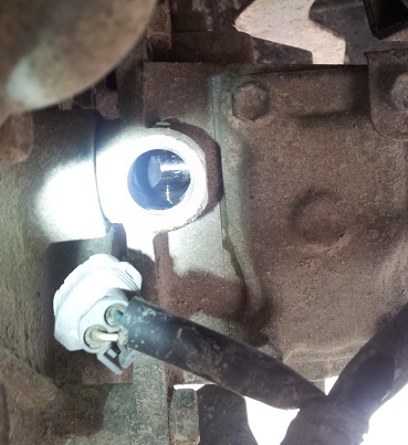

I believe this is the engage sensor for the front drive shaft on the transfer box?
Is this both how the sensor and inside the hole should look? I did notice watery oil on the sensor (I do a fair bit of water work).
Also tested VSV vacuum lines and both seem fine with no leaks/loss of suction.

In that case, this link has a guide on how to fix it for good.
http://www.hiluxsurf.co.uk/showthread.php?t=66755
This is the original link, but the one above has a lot more detailed pics.
http://www.4x4wire.com/toyota/tech/add/
Re: KZN130 Surf sticking in 4wd
Hey thanks for the links, yep I've seen that post before but didn't want to have to do that wanted to fix whatever was wrong
let me know if it fixes yours once you've done it!
