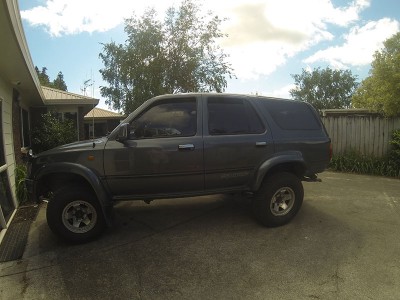

Hey guys this is my thirsty 3L auto, It's doing something a bit odd it feels like the clutch doesn't fully dis-engage and makes my take off slow with lots of revs. And instead of trying to fix and auto I thought maybe just doing a manual conversion was a better idea.
I was just wondering if there was a preferred way about doing this for you guys? any recommendations?
My most likely approach so far would be to raid all the second hand parts i need from a right off or wreck and switch them out? Just want to here what help you guys along your gearbox conversion journeys so hopefully I get to skip a few mistakes!
Any way I shall be updating this thread with the mistakes I make as I go so stay posted haha.
