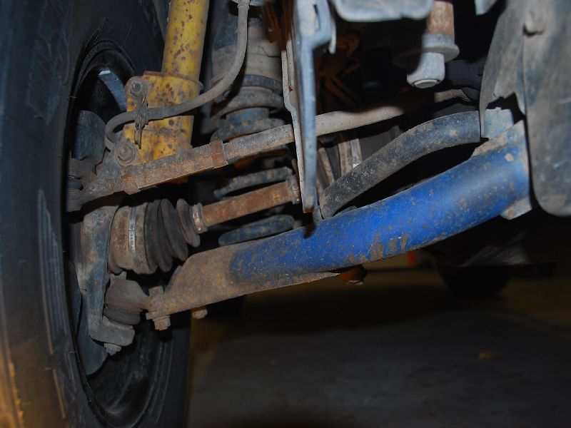

Have you had CV problems? Is that why you are converting to Hilux CV shafts?
My CV angles with my current setup.

You have given me some things to think about.
We are still unlocked, but expected to get selectable lockers in the next 12 months or so (either ARB or e-lockers). This means we do use "momentum is your friend" quite a lot. We have not had issues with the CV's, but a significant proportion of the research I have done indicates that they become an issue with lift and bigger tyres, especially the ones on the 26 spline shaft we have. We have always tried to anticipate such problems and put rigorous measures in place to address them before they become a problem - especially when it is a relatively well-trodden path.
The other aspect is that I would like to set this vehicle up to reliably run 33's in the future (plus chains). The upgraded CV shafts would likely achieve this, along with perhaps HD rear axles. The diffs, gearbox and transfer case should be good with the various rebuilds and bracings we have given them. But I have to admit some of this work (the hilux CV's in particular) is partly driven by an urge to see if it can be done.
The body lift goes towards providing that clearance, without the attendant issues or increased gentle of gravity associated with a suspension lift of the same size. Certainly our CoG is higher than standard, but between a suspension lift and a body lift of the same height, the CoG increases less with the body lift. Plus the 3" kit we are installing is more because they are full diameter blocks, not the narrow pucks we currently have.
That said, I look at your vehicle and see a level of suspension lift that works and I like that. We still have the Calmini springs and perhaps that should change. This is where we simply need to get some offroad km on the vehicle and feel for how it performs.
