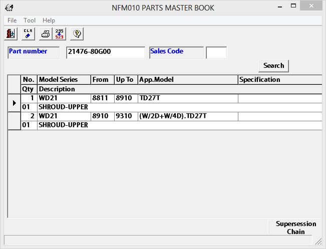

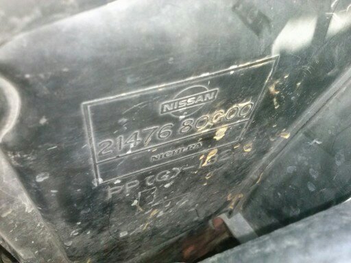

found a part number

Shroud's Original, Radiator looks Original

that's what I was thinking just by doing some googling.

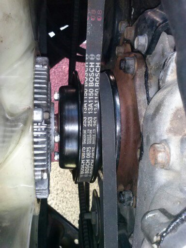

Fan is back wards :lol: :lol:
Never seen viscus fins sticking out the back :? Supposed to "sense" radiator temperature not block :D

sibainmud wrote:Fan is back wards :lol: :lol:
the fins on the viscous hub or the fins of the fan? it did suck a rag towards the grill

:lol: pretty sure the fans on backwards
muddymatt1973
Posts: 161
Joined: Thu Aug 29, 2013 11:28 am
Re: another overheating terrano
Post by muddymatt1973 »
BDR3M wrote::lol: pretty sure the fans on backwards
I agree....

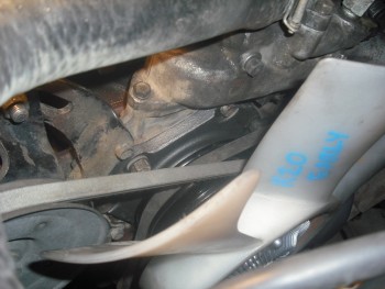

Cameron
Posts: 733
Post by Cameron »
I only just saw this thread and the first pic of the fan I thought that bad boy's on the wrong way round!

pain in the ass if i cant squeeze a socket n ratchet in there its rad out ....again! plus side i know the cooling system in this thing is a1 lol wish me luck flipping it at smoko

Turning the fan around won't change the direction of flow it will just be a bit more efficient and suck a bit more air, not sure that it will have much effect at normal road speeds, but you never know until you try, process of elimination.

That test would only work if you were reversing the rotation of the fan, Putting it on backwards will not effect the way the air moves just the efficency. Fix the fan as simion said( reminds me of my childhood) and put water wetter in it and your troubles will be gone.
Terranos will always run hot there isnt the room under the bonnet

rad out again must have gone through 10l of coolant during this process, yep better try everything, im hoping the extra air flow will solve it with the fan how it was im guessing the air was already hot from the transcooler and condencer.
