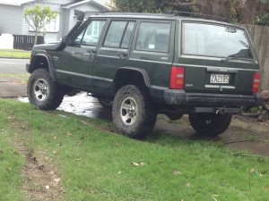

Well i finially brought one 95 xj 3inch lift worn 31's brought cheep, but needs a bit of work.
Firstly i need to replace all the fluids so any advice on quanitys and type would be helpful.
Secondly the previous owner said the front diff was noisey and on its way out.
Thirdly the 4wd selector is not conected to linkage under truck and will not move ? and what looks like solendoids at rear
have had white wires cut off.
i hope ive explained this accurately and any suggestions would be great from those who know jeeps.
Or a good jeep mechanic in the auckland area.
Thanks in advance for your replies Ben

just under 6 litres with the filter, i used a flash synthetic in my bush truck ,my roofless xj runs cat diesel oil ,auto just takes normal atf, front diff is probaly just bearings,parts are dirt cheap so dont worry if you need a frontdiff.just hook the 4wd lever back up and will be sweet,just make sure you adjust it so you can select lo.a good basic 4x4 that dollar for dollar will outperform most .motor and box is pretty much bulletproof, weakest thing ive found is the front diff, took 33s and lots of roughness to break,i just welded mine up rather than put my spare in, going to jap diffs eventually, only as bad on fuel as you make it.first thing i did on mine was bonnet vent and moved the air intake.
