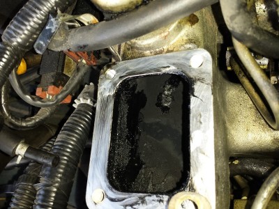

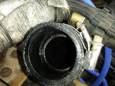

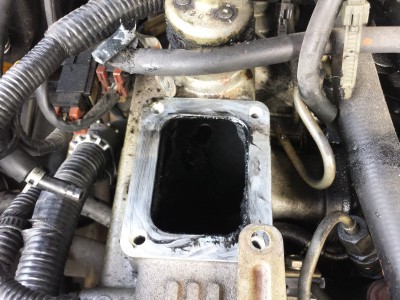

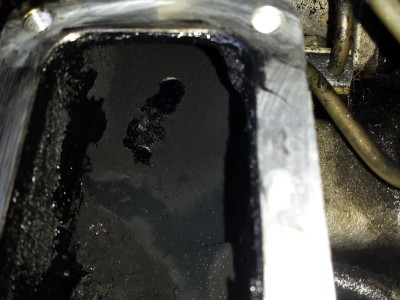

Hey guys,
I'm new here and came across the side when I googled about removing the EGR from a TD27.
I've done a fair bit of searching and have found bits and bobs about removing the EGR but havent found any start to finish sort of instructions on what do to and what to remove. Reason for removing the EGR is after i removed the top part of the intake manifold and looked inside the manifold, she looks pretty manky. I'll include some pictures below also.
On another note does anyone have good tips on removing the intake manifold? I'm wanting to clean this right out at the same time.
