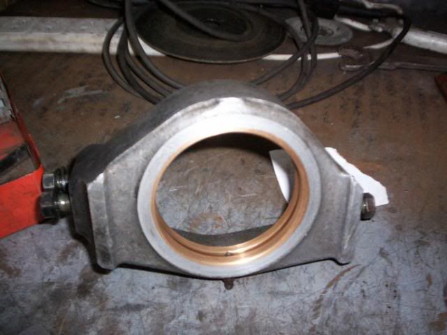

The other thing that may cause this is brass/bronze?? ring inside the mounting collar where it it supposed to be greased, they wear unevenly so allowing movement between spool & mount possibly slightly jamming it.

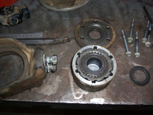

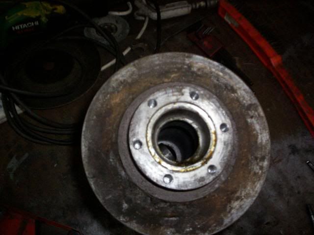

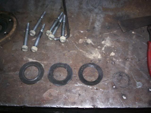

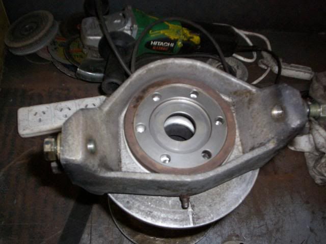

Very Very helpful especially the photographs, Many Thanks.
Just too update progress - took cable of the drum and drilled a small hole through the drum toward the shaft. Used oil can to squirt thin oil and crc into the cavity between the inside of the drum and the drive shaft. Removed the hub. Used gas torch to heat the drum and put a set of the mole grip pliers with the chain end around the drum and tighten and levered the drum back and fourth and it now moves freely. However, when I put the hub back on and tighten the allen screws the drum tightens and can't be turned, slacken the allen screws and the movement comes back. The hub is working correctly on free and drive so something is pulling and jamming when the allen screws are tightened, any idea's ?
