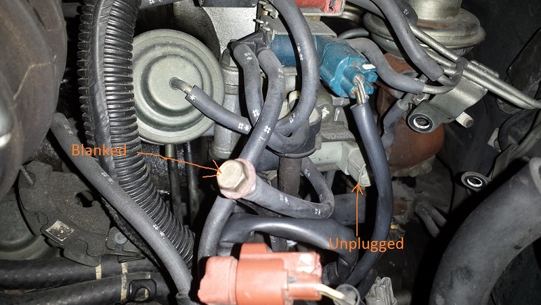

Hi all, I have recently brought a surf with a 2L-T in it, I did quite a bit of research so I am aware of the issues they have with overheating but got a really good example at a good price and decided to have a go with it.
I have started to rip the EGR system out and have an EGT setup waiting to be installed. When removing the EGR intake pipe from the EGR valve I noticed (or maybe I broke - not sure) that an orange sensor was broken, and that another sensor had been disconnected and the vacuum hose off it blanked with a screw.
My question is what do these 2 things do and do I need them or are they removed with the EGR stuff, hopefully someone can help.. Photos are below showing the 2 items.

looks like someones disabled the egr butterfly setup.
however you will probably find it shakes a fair bit on engine shutdown. other than that its a good thing.

Hi Ryanjury, that’s a solenoid valve that’s broken there and it's used in the operation of the EGR and butterfly setup. Not such a big deal on those.
How far with the mods do you intend on going? With the 2Lt being mech injected you can get some quite good gains out of it making it quicker than an early 1kz. This doesn’t really take much work and you have the ability to make it run a little cooler too with some boost mods.
