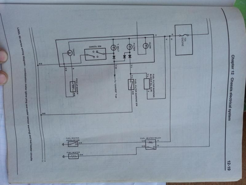

Putting new dash into my ute, out of kzn185, using the speedo cluster out of an ln167 ute, so I need a wiring diagram for both of those speedos if anyone can help?

Have got an ln167 diagram from a Haynes manual at the library, But can't for the life of me find one for an ln106, they had the manual for petrol hilux's and I have the manual for surfs/4runners, but just cant track down the one I need.
At the moment I have the 167 harness from the back of the speedo with connectors on it for the wires that I think I need, and I have a few cut in my 106 loom, but now I am really stuck.
If anyone is able to help it would be very much appreciated.

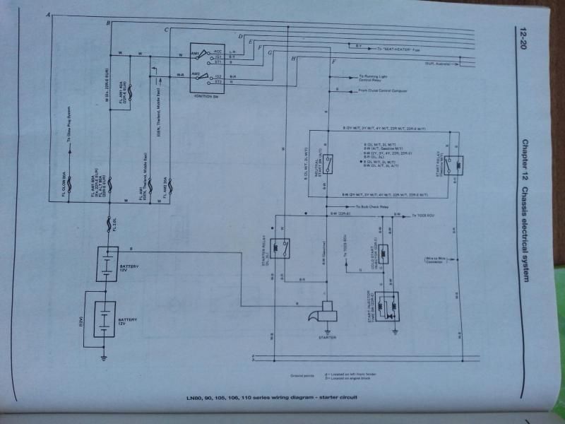

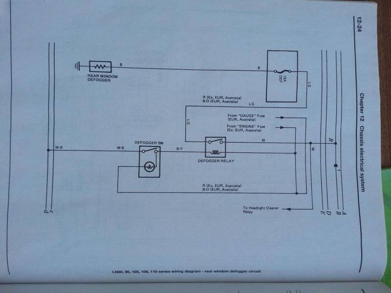

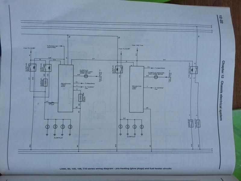

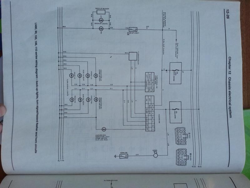

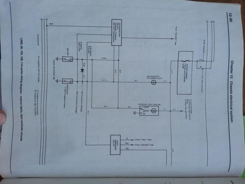

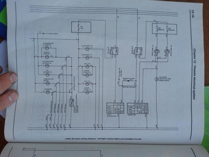

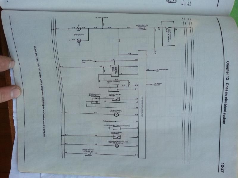

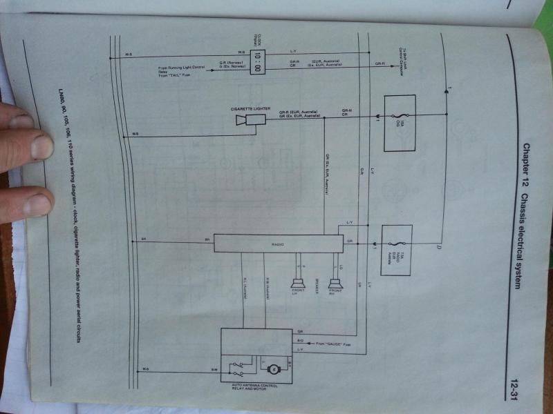

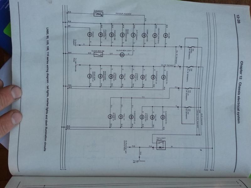

sorry for the delay uploading them now
Re: 92 Hilux speedo wiring diagram needed
Complete wiring diagrams from the manual.
If you need higher res pm me your email
Wicked thanks mate!!
Got both indicators going, high beam light and handbrake light, also got rid of oil light staying on (somehow)
Think temp gauge needs adjusting
I will give them a go and will message if I need hi def photos.
Again mate thanks a lot
