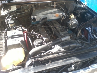

big brown
Posts: 19
Joined: Thu Jan 09, 2014 9:50 am
Re: need more power!!! td42
Post by big brown »
Cpl pics
2013-10-19 09.28.14.jpg (68.16 KiB) Viewed 9183 times
Crash bandicoot
Posts: 2924
Location: Towing a hilux
Post by Crash bandicoot »
I think if you are prepared to go back to the drawing board so to speak you should sequential turbo charge it to achieve the desired broad power band it seems you are after.
, as you will only do one of two things with a big single turbo and the type of feet and load on it.
melt a piston or kill the transmission.
It basically sounds undriveable at the mo. if you can't use over drive to cruise due to lack of torque or poor gearing then it'll only ever be good in low range. ..i.e trailer queen.
ideally with a big six you should be making peak torque by 2000 rpm and horsepower probably around 32-3800 rpm with an after market set up like that.
