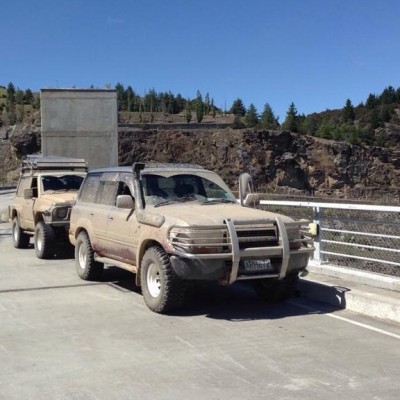

Here's a cupla pics of the truck, anybody heard of those transmission valve body's that are supposed to be good? The change isn't flash on the old girl but ok. Ideas for the truck are a removable bed with underneath storage and a reel out changeroom, like a reel out awning, all ideas.
