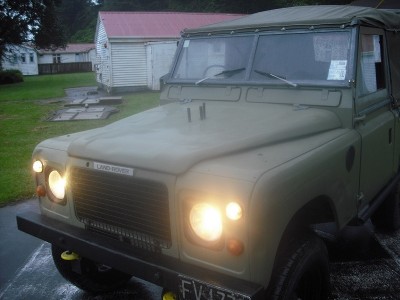

Hi guys, my old man recently sold his '03 Defender and has "upgraded" to a '67 series 2a.
Its very tidy and doesn't need any work body chassis wise, but hes not going to stick with original 2.2 as wants deisel and pulling power.
Want to run with toyota gear as i have access to cheap parts and have knowledge to fix etc.
He wants it simple but wants it future proofed.
Current thinking is hilux axles/diffs and disk brakes, with landrover suspension.
thinking here is i can do this part myself, he doesnt want massive flex etc, but gets good brakes and running gear.
And possibly 13bt toyota engine and box, or 3l/5l and can turbo in future if needed.
I know its sacriledge to do it to a tidy original landy but he wants this to be his last car, so its gotta do another 25 years ish! ha.
So my question, has anyone here done this? or close to it?
Got any other ideas?
Cheers for any and all input.
Micah.

Decided on a 3l or 5l diesel, not too fussed with noise, virbration etc, its a near on 50 y/o landy. Questions now are, he wants manual, so we are thinking running with r151 box and 70 series transfer. That way can have pto option. Hopefully if its not too long for the short '88.
Is there a bell housing that goes L series motor to r151 box?
Yeah going to get parabolic springs.
Running toyota gear as its known and easy to get parts etc.
Are hilux diffs both offset to the one side?
Also, would it be hard to set up power steering? Motor will have pump and reservoir
Running with the hilux set up? Or just stick with rover set up. Will do more research on this too.
Cheers for the input guys.
