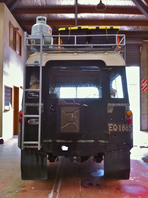

I have parabolic springs on my 88" 2a and the drivers side is sagging a bit lower than the other now by about 40mm partly weight distribution but even when unloaded it sits about 25 -30mm lower. Is it possible to have these strengthened or do I just replace them with new or go back to normal leaf springs.

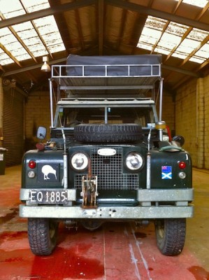

If that photo is your Land Rover then you are probably overloaded for the Parabolic springs. They generally do not take the same load rating as normal leaf springs.
The other point is were the springs handed and did you fit the right hand one as it should have?
Due to the torque of the engine, the weight of a side mounted fuel tank and driver LR used to have an extra spring leaf in the right hand side to counteract the additional weight.
As you say have a talk to the local spring manufacturers for their advice as to what can be done.

You are probably right about the overloading as they only have two leaves in each spring. I didn't fit them they were on it when I bought it. This is my land Rover and it is ex army so has a fuel tank on each side. I try to balance out the weight in these. I think they are just too weak for the purpose I'm using it for.

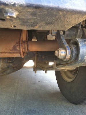

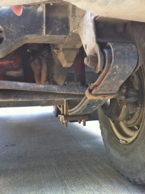

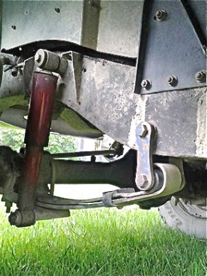

Here is a picture of the front passenger spring (the best spring) without any loading on it, no roof rack or anything empty truck. The drivers side is a bit flatter than this and the rear springs are flatter still.

that would be ideal if the rover had been loaded,
you could always add a leaf without retempering the original springs.
try swapping them left to right first to see if the truck levels out or gets worse

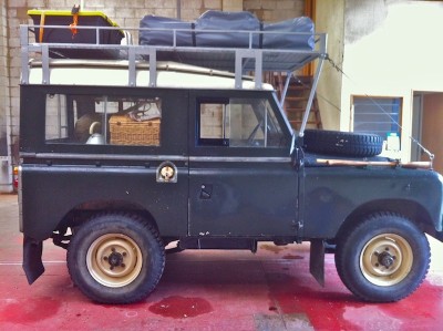

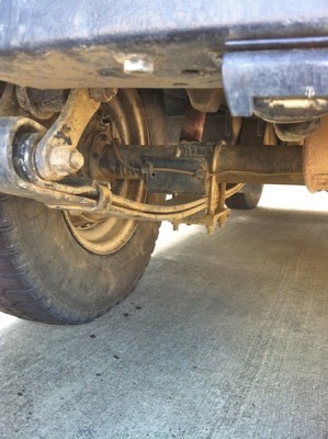

Here are all the springs under loading you can see the front isn't too bad but the rears are flat.
Im going to do what you suggest and put a leaf in and see if it improves anything before I start spending.

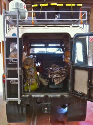

I have two fuel tanks. One on each side. So they balance out. The batteries are are a bit of a problem as I have two both on the drivers side.

I have all my tool kit on the drivers side. Socket set, trolley jack, toolbox etc.

Cracked It!!
A wet afternoon spent in the shed moving stuff about from one side to the other.
I can't believe how sensitive these parabolic springs are. About 20kgs shows 5mm difference in height.
She is sitting perfectly level now and is a good 30mm higher than before with the new springs.
Just need the rain to go off and it will be time for a wee trip.
Thanks to everyone who commented it was a great help.
