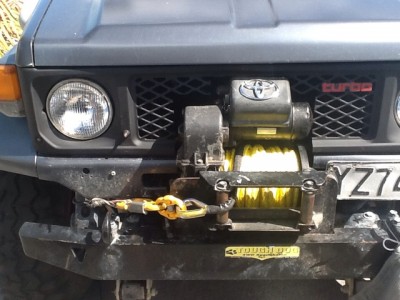

Evening All,
I have around 50m of 12mm of Dyneema rope that I intend to put on to my Hi Mount winch.
I am struggling to find a Hawse type fairlead with bolt holes wide enough to fit the winch mount.
Has anyone out there kept using roller fairleads with synthetic rope? I can see that pinch and snagging might occur when under load and off centre winching.
Look forward to hearing the opinions and experience out there.

i used to run one of those as a back up winch ,thought it was far better than the warn ,free spools much better ,i used to run 40mtrs of 10mm found any more and it was prone to jumping over the side of the drum and if winching on say a 45deg angle and it spooled on one side it would jamb on one of the stays
snotgoblin
Posts: 290
Joined: Mon Feb 06, 2012 8:26 pm
Re: Synthetic winch rope
Post by snotgoblin »
Got all 50m on the drum. Went into work and hooked on to a big skip bin and walked the ruck down the rope.
Rope is close to part of the mount - so will mod that in due course.
Will go to hawse type fairlead too I think.

I use rollers as the ali ones get hot and "could"melt the rope.. which for me is no go.. Rollers in good condition will work better IMO as there is NO stress on the rope as it pass's over/on the fairlead.. but really it's your truck and you use it how you like.. :wink:

You can also get plastic rollers as a replacement item... Not sure if they will fit your fairlead, but if you got a worn out one cheap and re-furbished it then it will be fine.. I use rollers and syn rope, i dont forsee issues 95 percent of the time i will use it...

Has anyone taken the rollers off and sleeved them with a piece of UHMWPE plastic for best of both... Saw it done somewhere.

I tried the Big heat shrink on the rollers and worked out pretty good until I tried to pull the front of my truck in through the fairlead.. it fkd the plastic shrink and havn't replaced it as of yet.. still waiting for a delta contractor to have some for Freeee.. lol

I wonder if I can make up some solid PTFE rollers, maybe with a steel sleeve...

That would work as long as it had the steel shaft and maybe metal end caps or the likes.. Great idea..
