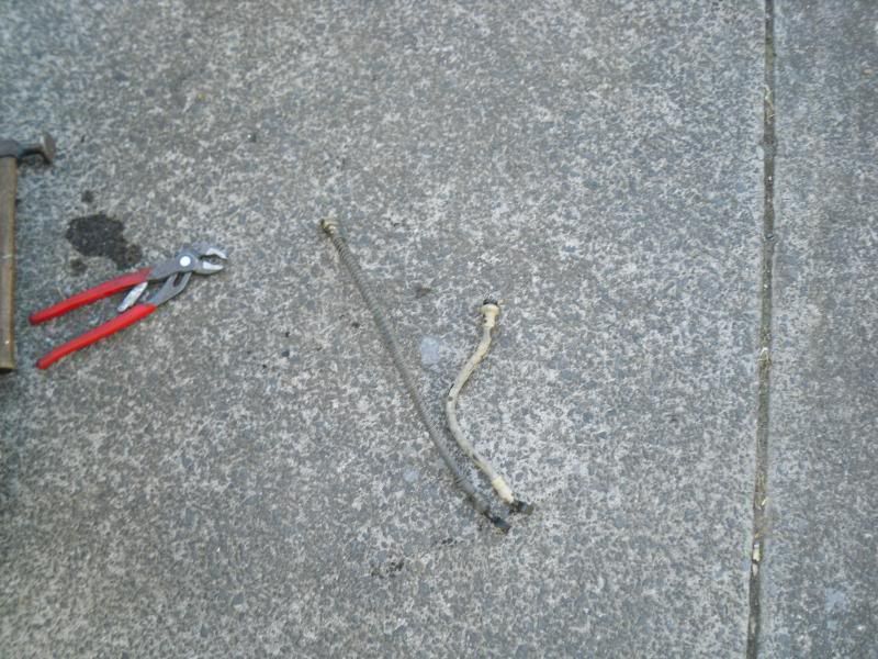

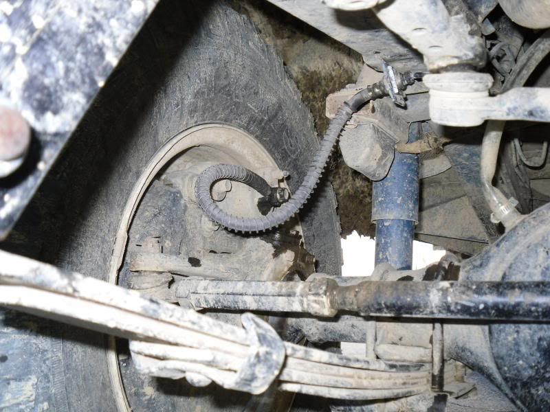

just check out a wrecker.. you might find something suitable.. i found some off an old hyundai sedan that are perfect. sorry don't know the year but late 90's sonata maybe
