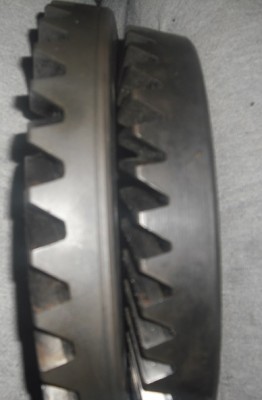

taz01 makes a good point about the MQ front diff. Its the C200 2-pin 8-incher, in something like a LWB Patrol thats starting to push the strength boundaries. Although the ring gear depth is the same as the H233 GQ front, you're still working with an 8" as opposed to 9.25" unit, heres a pic I just took of MK and GQ front gears side by side. FYI The MQ rear is the same as the GQ front.

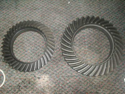

Now re the whole clearance thing, check this out:
Heres a photo I just took of the Nissan GQ Patrol 9.25" ring gear next to a Rover diff.
I'm not going to dismantle the Rover diff for the sake of this demonstration, but the Nissan gear is only slightly larger in diameter. Eyeballing it I say the Rover looks like about 8.5" or Dana 44 size. So is the loss of clearance caused by case design, or...?
Now heres the 8" Nissan MK Front next to the Rover diff.
Here is some photographic evidence that demonstrates how the Nissan 8", like the famous Toyota 8" is actually smaller and more compact than the Rover but much stronger by its very design. Note depth and thickness of teeth. Both ring gears are standard cut, similar ratio.
