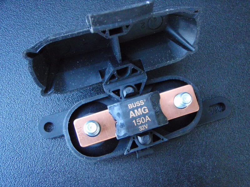

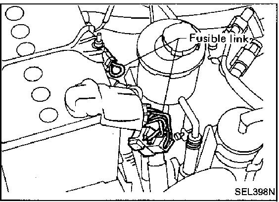

Older nissans had fusable link wire instead of main fuses.
These are special bits of wire just off the battery positive terminal and usually unplug. Check these out
You have most probably damaged the alternator as well. But need to get it going first then check it out

What he said. The fuse links will plug in and the easy solution if they are blown is to get some from a wrecker, Grab a test light and probe both sides to check them as they normally look ok, they are usually brown or green. There is a good chance you will have blown the diodes in the alternator.

Hey guys, thanks a bunch for the help. I can't seem to find this fusible link, however I did find a plug with white grease like stuff mixed in with some black covering the wires, going all the way through the plug. I cleaned this stuff up a little so the metal in the connections are actually visible (therefor actually touching??), I also found the starter ground melted and burnt, so I put a new connection on.
