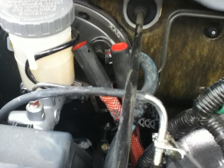

I ended up in super cheap and found these oil breathers
So will hopefully do the trick
