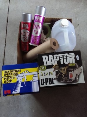

Picked up the kit from Car Colors of North Shore. Great guys, threw the spary gun in for free (because they still had some left over).

It cost $250 (but I got the gun for free and borrowed a compressor from someone). Ended up using 3 bottles for 3 coats to cover the inside only. This is what the texture is after 24 hours.
