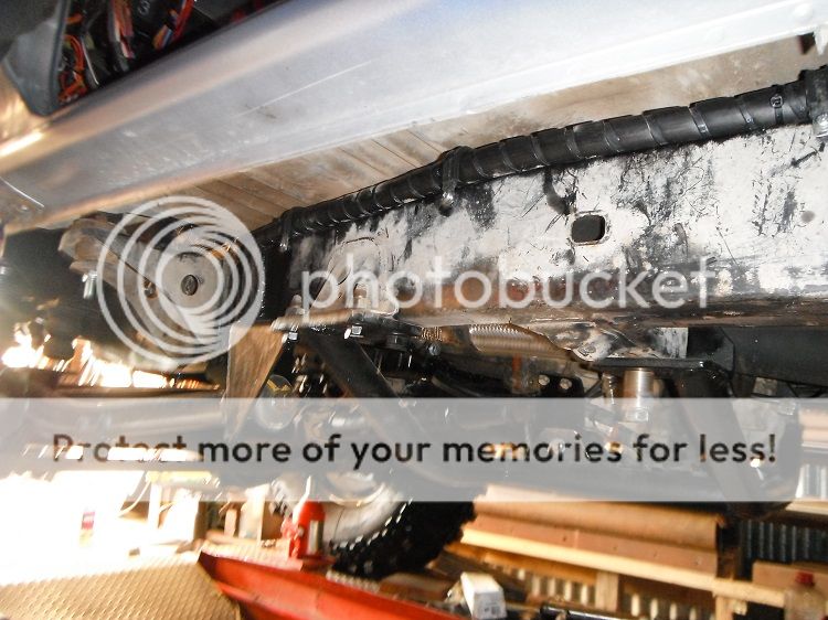

well have started on some small er pieces while collecting other parts. trying to get ready for a dyno tune, before startingbarwork have got intercooling water pipes all in place and mounted to chassis. whipped up a heatsheild.
foImageund a gap and made up a rad overflow tank, still need to fit a neck and cap onto it holds about 1.8 litres
in the gapImage
got fuel filler and tank breather in.Not 100% sold on positioning of breather but couldnt really think of anywhere else to put it.Has a roll over valve in the tankImage

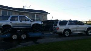

Well loaded up and gave it a wash,2 years worth of build up on it...... D-day is wensday...... tried to attach photo from phone but didn't seem to want...

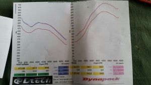

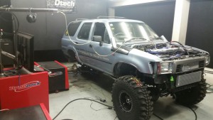

Main part of tune is done. I thought waste gate springs were 5 psi, but open at 6.5psi 238kw on low boost at the rears I believe 10psi brought another 31 kw. So 269kw atrw ... I was hoping for maybe 250. So allllgoood:)

Worthless with out pics, here's the final dyno pull, high and low boost. Don't have print outs of it (should have taken photos, didn't think about it ) but full boost at 2600rpm and held it until the limiter :)
