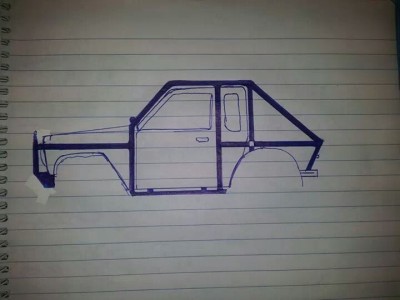

Thanks dude, not 100% on how im going to do it but basically I want it to end up looking something like this:
I havnt planned how to layout the deck yet but I will be going rear mount alloy radiator and decent sized air tank, and plenty of lighting.
