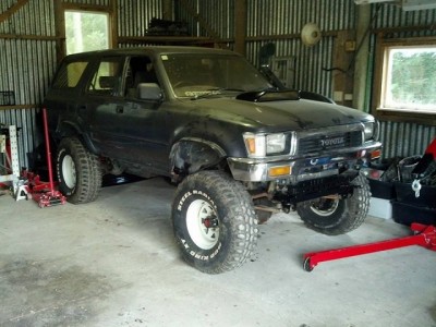

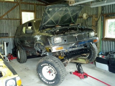

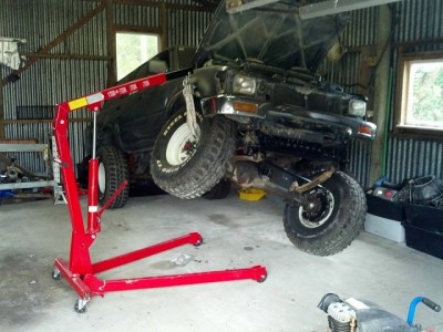

Cheap and easy flex with leaves they work well and are simple
If we lifted from the rear wheel would have got full articulation out of the front,so bear in mind there's still some to go droop wise in the front.
trucks on 35's,1.45m to the center of the hub front bumpers at shoulder height,

think I just changed my mined ^^ is this coiled rear?

Yip all 130 Surfs are coil rear
Re: sas'n up my surf
tomsoffroad wrote:truckingood wrote:think I just changed my mined ^^ is this coiled rear?
Yup like tom said. the truck has 50mm body lift (gross) 50mm rear spring lift some old hilux rear leaves 50mm extended shackles? 50mm drop front cross member, and the rear suspension now lets it down,

Maxed out the jack easily and the rear is slightly lower when sitting flat.

Yea mate leaves can provide heapsa flex if set up right. Just Dont let your shox restrict ya
