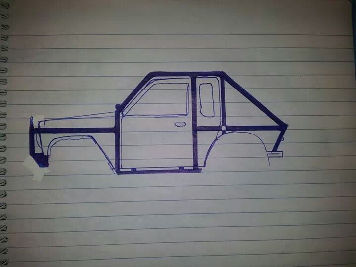

Thanks dude, not 100% on how im going to do it but basically I want it to end up looking something like this:
I havnt planned how to layout the deck yet but I will be going rear mount alloy radiator and decent sized air tank, and plenty of lighting.

Progress looks good mate. Are you going to run a internal cage to tie into the exo?
Re: Filthy Safari
Thanks dude. Im quite pleased with the progress so far.
No plans for an internal cage at this stage, will be doing a 6pt exo cage and front bar.
