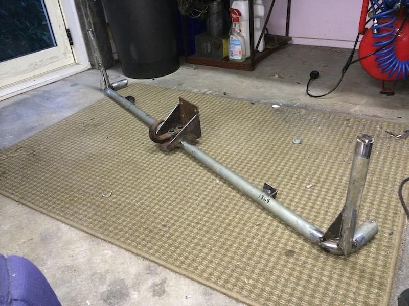

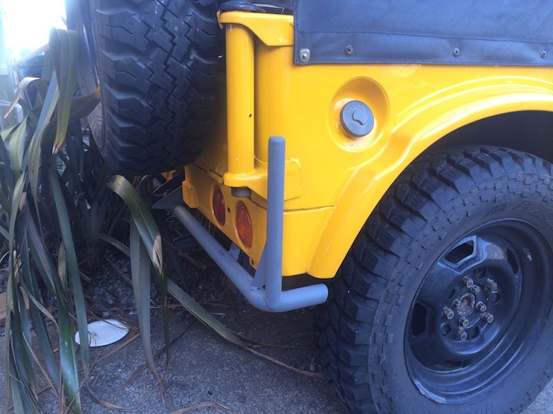

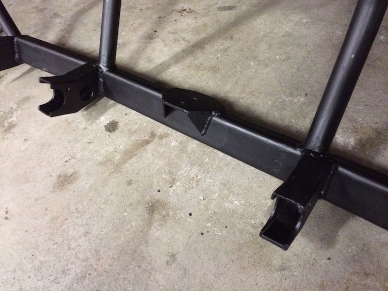

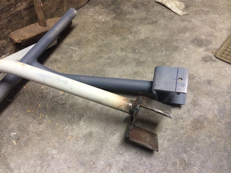

New Rear bar for the LJ 8)
Blazed it up and primed it this arvo , but forgot to take pics....
the outer tabs bolt through a hole drilled in the shackle tube bracket .

That looks great, nice and simple but still offers heaps of protection.

zukmeista wrote:That looks great, nice and simple but still offers heaps of protection.
yeah its all about trying to keep the weight down as much as possible, give good protection , while still looking ok
Weld bends make fabbing this sort of stuff quite easy .

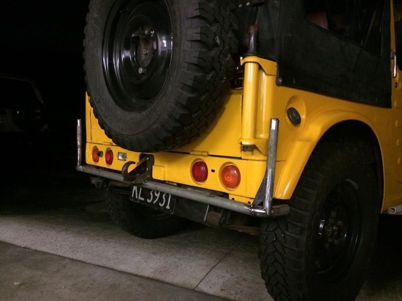

Better pic of it blazed and primed up.

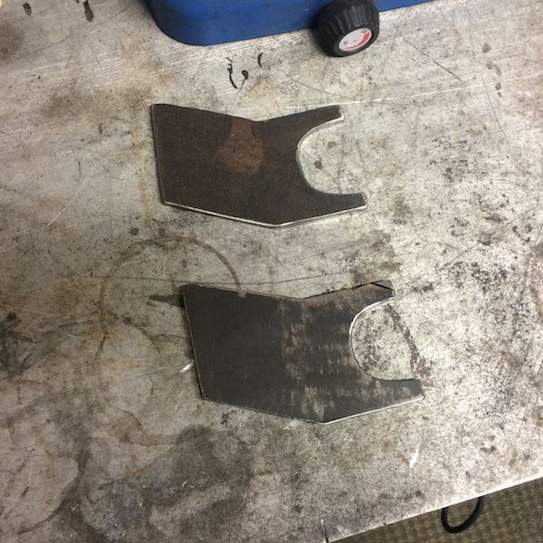

Also made some rear chassis mounts for the sliders last night, as i diddnt realy want to drill holes through the chassis.
And first phase of the Bullbar mounting brackets

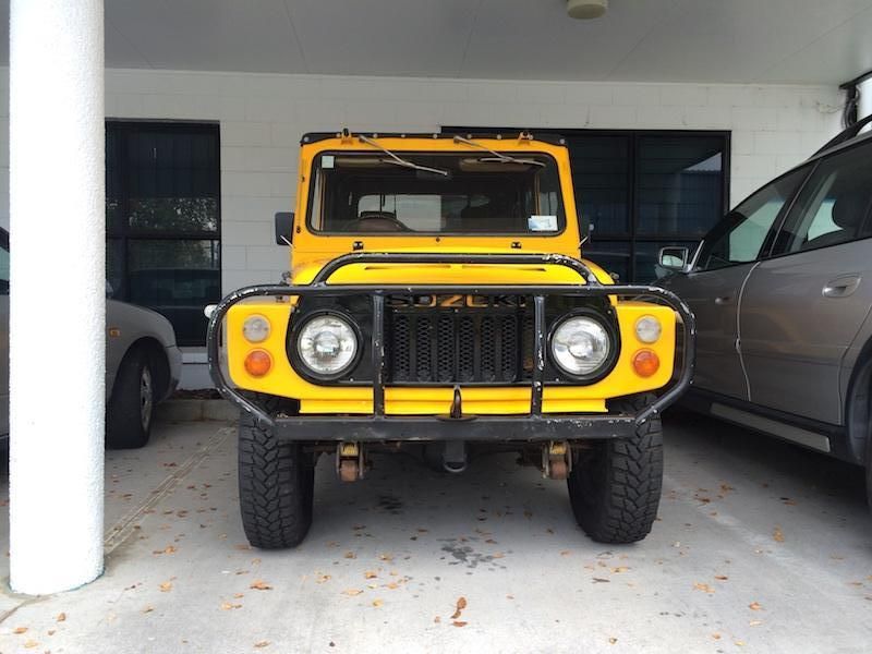

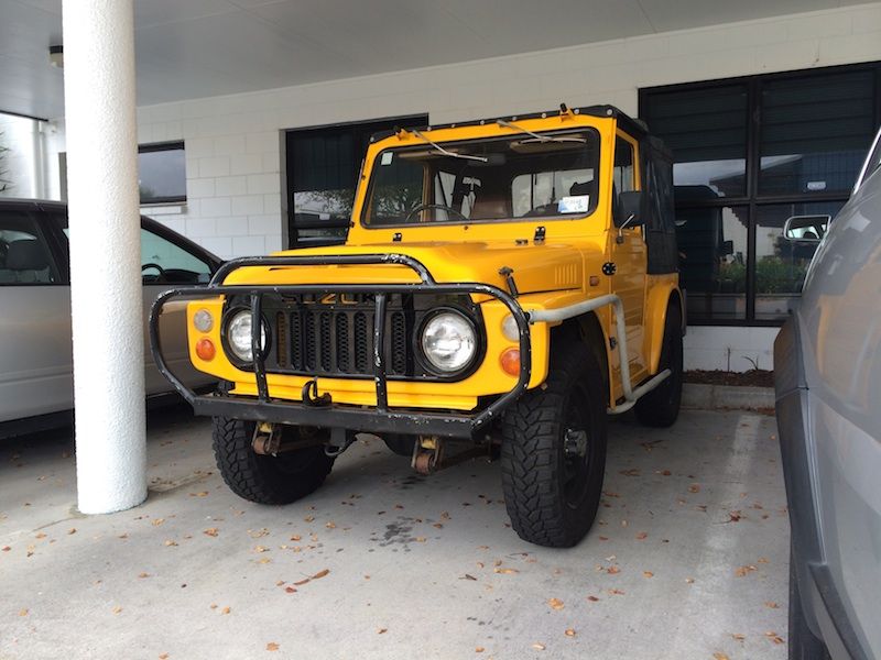

progress on the bullbar mounting :mrgreen:
Chassis brackets are complete , hook mounting in place , just needs a final coat of paint now

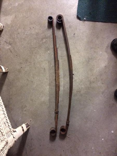

Also changed out the seriously inverted factory front springs for some sagged SJ410 ones
Still ended up with a 1" lift :roll: . diddn't really want to change them but after adding the bull-bar and side bars , I was hitting the bump stops when driving on the road :shock: :shock:

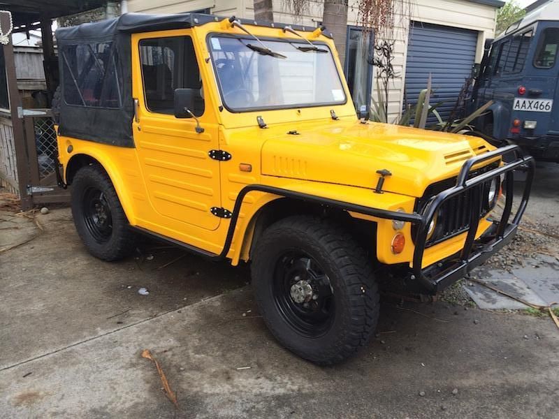

Bullbar on

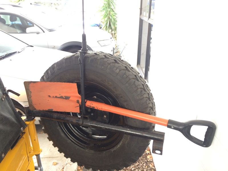

Also made a antenna mount and spade holder for the spare wheel carrier

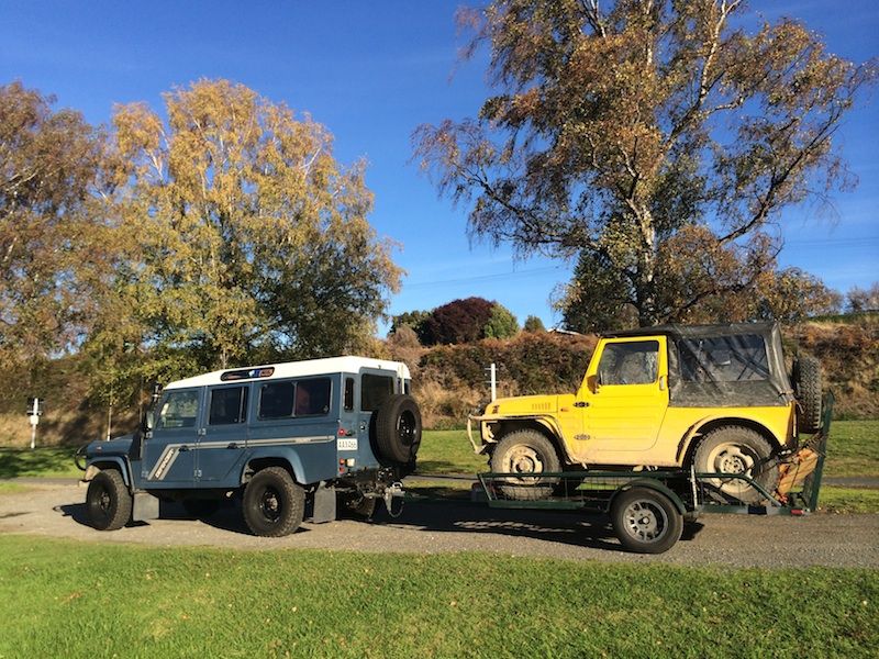

The Tow Rig 8)

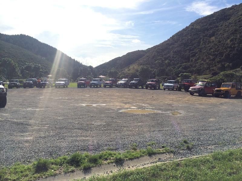

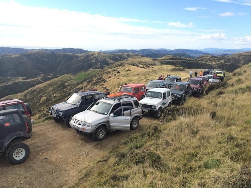

18 Suzukis lined up ready to go ........ They were all waiting for me to turn up :oops: :oops:

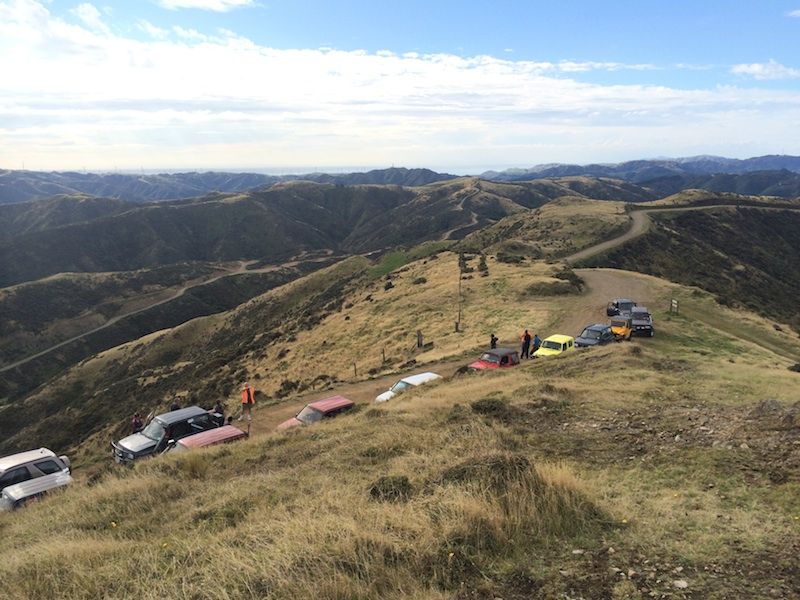

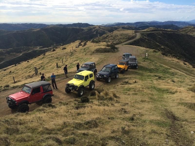

Ended up onto top near the wind Farm
Views from on top towards to the north
Sandy looking tiny next to the modified trucks
