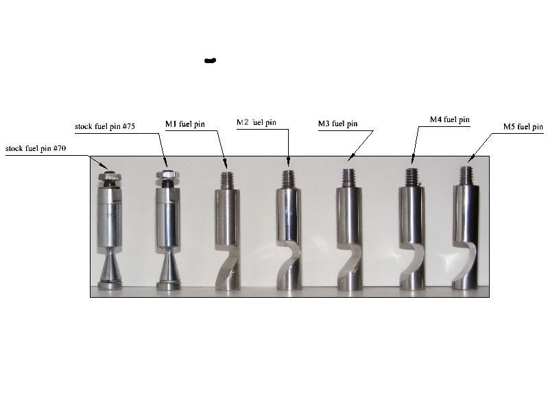

The shim or pin top should be about 6-6.2 mm from the top , the deeper it travels into the taper the more gas you will get and as you said if you go to far it will hit the top ,
You can get some trick pins from overseas with custom ramps in the pick attatched ,
You can also grind yours or extend the flat and get it re- hardened,
It sounds like your egts are getting close to the comfortable limit also ,

Trundle wrote: You can also grind yours or extend the flat and get it re- hardened,
They aren't hardened, just polished. Did a mild custom grind on mine and its made a hell of a difference!
