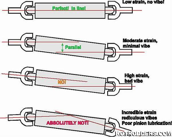

Sounds like a recipe for drive line vibration there !!!
Heres a quik pick of setting up diffs for higher drive shaft angles ,
getting the pinion angle to directly corespond the output flange is crutial unless you want ridiculously bad driveline issues , We use a magnetic Starret angleometer , For example if you do a 4" lift in a gq SWB the pinion on the diff sits at 9 degrees upward and the gearbox output at 3 degrees downward , Obviously you want the angles as low as possible but we space the gearbox down and extended the rear lower arms do get the angles matching at 5 up on the diff and 5 down on the gearbox ,
Sorry to get off topic i just couldnt understand how increasing the front diff pinion angle would help him ?

I think the suggestion around the front diff was actually to lower the entire thing. This keeps the CVS flat and allows for better travel.
