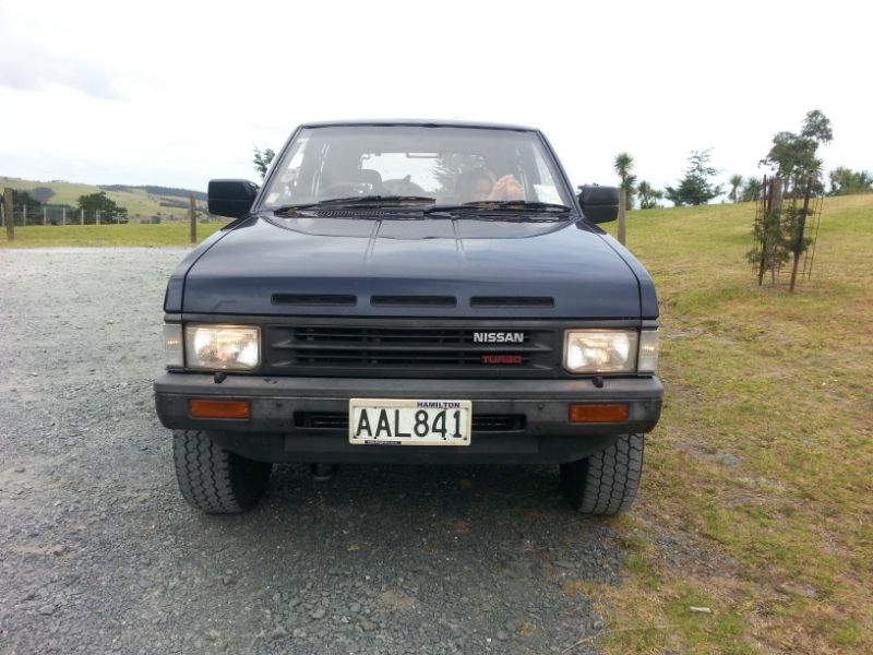

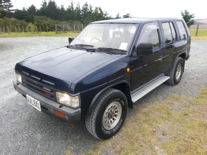

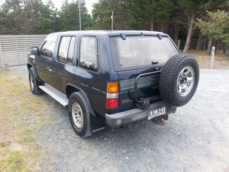

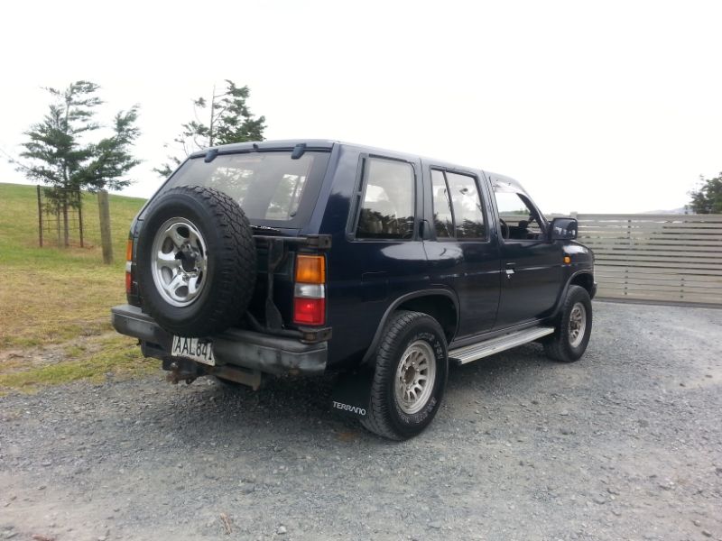

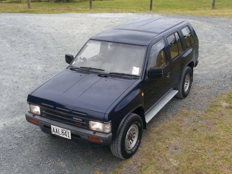

before photos
These photos are a few days after I bought her from Hamilton, with nothing but 1 rear shock bush needed for a warrant, Look at how straight and clean she is!
Re: Hi All
if doing offroad them side steps will bend up fold ect , removing them would be a good idea

Welcome, Cool Pathy, super clean

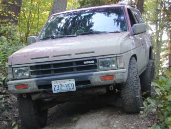

^^By the way that one was running Interco 34x9.5, 0" lift, factory ride height, factory steering, worked VG33, Nismo front LSD, rear spool and had the absolute shit beaten out of it without breakage

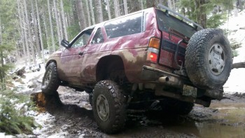

^^100% factory, no mods whatsoever except removed swaybar, 33x10.5 KOs.
