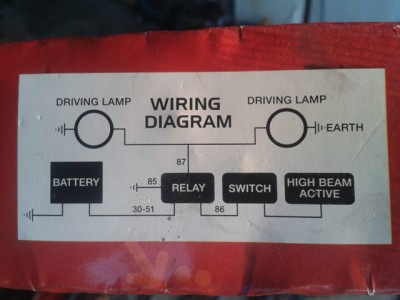

Hey mate,
Here's how the wiring should go if it helps:
