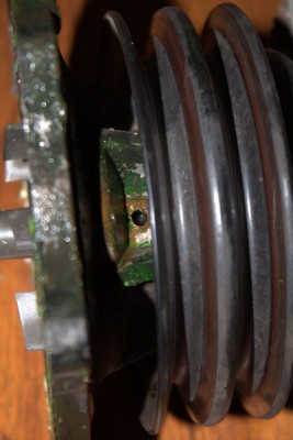

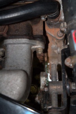

Starting to lose coolant occasionally. I have water stains running down the front of the sump. There is what appears to be a thin cover behind the crankshaft pulley, and it has some sort of a rubber dust seal around the bottom of this cover. It appears wet here.
I haven’t found a mirror and light yet to have a look up under the bottom of the water pump, but have what I found indicate a sure sign that the water pump seal has gone, or are there other things that can leak on the front of engine?
I haven’t slackened the belts yet, but I can’t get any movement of the water pump pulley (belts aren’t that tight) and there has been no odd noises. Do the seals fail by themselves or only if the bearings go?
If water pump, is rekitting an option, or where is the best place to purchase from?

Water pumps on these do fail. Get a mirror and check the weep hole under the pump. Most other common leaks are around the lower thermostat housing and this leaks down under the intake manifold.
They are non repairable and a pit pricey to replace as they come with the fan hub attached. Also there are a few variations on the pulley so you might need yours off to get the right one.

Pretty sure your water pump is the 143mm fan hub.
I've bought two for around $120 both made in japan.
There are two holes on the water pump, and they leak with the seal has gone.

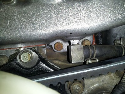

Also the sandwich plate can leak, mine did. Which involves taking lots off including timing cover.
Im not sure if yours has a cooling pipe for the turbo that comes from under the thermostat housing as this can also leak.

doesn't seem to be leaking today while I have been looking. Maybe this suggests the seal, because all the other joints would leak consistently right?
I can't see drain hole under pump, maybe hidden by pulley which is close to housing on mine, however there does not appear to be any water stains around bottom of pump. Took the belts off pump and bearings are quiet and no play.
It's quite hard looking around in there with mirror.
Who was the supplier?

Shouldnt be to hard to see where it is leaking.
Do you have green rust inhibiter in it? That stands out.
Hose it off and take it for a drive and look again .

no, I have an orange colored antifreeze, and I don’t think it is so obvious to see. I had big puddles on the ground yesterday, and it was wet at the sump, but today it is totally dry, now I have been looking with the bottom cover panel off.
I was thinking about the water pump. Mine being the one with pulley close to the housing, the drain hole would be under the pulley right?
If so then it would drip on the pulley first, run down the pulley and drip off this missing the water pump housing maybe?
The clean dry looking bottom of the water pump housing was making me think it isn’t the water pump, but maybe the coolant just drips past it.

It could be dribbling down the housing and not touching the pulley.
Mine did that.
It was the same pump as yours by the sound.
Cost was $212+ trade price from BNT.
There are 2 types listed for the R50 TD27, alloy or cast body. The alloy has the pulleys very close to the w/p body.
Part numbers are N65AF (cast body long snout) and N80 (alloy body and 2mm approx clearance).
Hope that helps.

Finally have confirmed water pump! Just couldn’t see it with light and mirror. There was no tell tale stain either. Worked it out by pushing a tissue in between the pulley and housing.

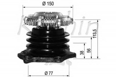

I've just based it on how far apart the fan blade bolts are.
135MM for a navara
145MM for Terranos
135MM for a navara
145MM for Terranos

Thank you. I hear what you are saying with the second hand one. I didn’t want to go down that track.
Attachment picture is different to mine. Didn’t find my one on the Butlers website, but the China one may be the right one.
I’ll try to get a fan bolt hole spacing from the new one I’m looking at. At least I can return this one if it isn’t right.

Still trying sort sort a cost effective option, short of importing from overseas.
I found a suitable cheap pump with the wrong viscous fan hub on it. (135mm fan bolt spacing instead of nearly 145mm) Maybe I can change hub over.
Just wondering how the viscious hub is held on. Is it a press fit, screwed on, or other.
The other option is to try and find a fan to suit this new pump. If this is an option what vehicles has a suitable fan for the smaller hub?
The other option is to make the centre of old fan fit the 135mm bolt spacing. Any clever ideas here?
If i do order from overseas, how can i be sure that i will get the right one. When i tried to purchase at local shops, it was quite a mission, basically having open boxes to check which one. Retail prices around $400 sucks...

Cannot change fan hub as the are pressed on.
The fan to fit 135mm is smaller.
Best to get the 145mm
