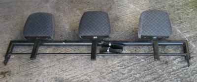

Ive got 2 little girls aged 11 and want them to be reasonably protected. I have looked at all the replacement seats out there and there are plenty, all with head rests for the outer seats but can't seem to find any for the middle seat. Saw this rack system I thought was quite cool.
Anybody overcome this problem before?

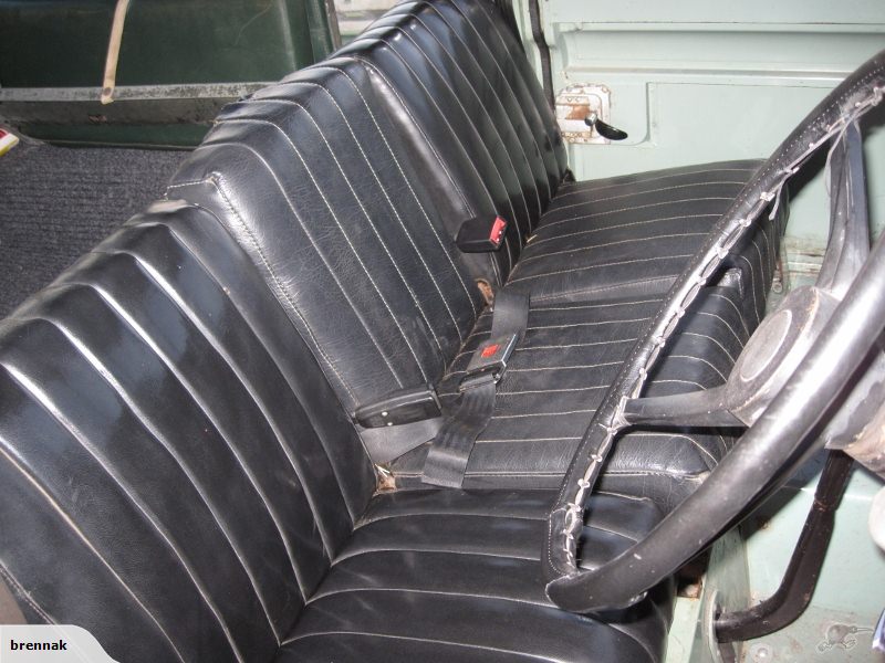

reasonably well protected and rover is a stretch,
the dash is steel and the belts aren't even inertia locked.
in saying that though I reckon a set of decent belts and highback seats would be a start,
the headrest should pretty much line up with your ears.
I reckon three jaz poly seats with removeable covers would look good in there but don't expect much cushioning
