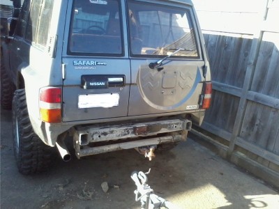

went to set the tappets today after the reface but didn't have a tool to turn it over on the crank so now next weekends job. instead pulled the old sagged guard rubbers off to check guard clearances, thinking they will need some trimming, what have other people done with that plastic part on the rear guards as i'll need to put flares on to cover tyres still but if i cut it i'll lose the flat to screw to. pulled the rear step and bumper ends off to get ready for rear quarter chop. has anyone lifted the fuel tank in one of these before? i have a two inch body lift so have a bit of space to lift it just wondering how others have gone about it. Towbar to come off and will build a rear bar up
Re: long slow gq project
pulled the plastic bit ,silicones around the clips ,sweet

I found with trimming guards 35mm front and rear fitted 37s easily no body lift but had 4" lwb spring lift in a swb so you have 2"body and 2" spring 35s should clear as for the plastic bits cut em and make 5 or 6 90 deg brackets to hold flares in place

taz01 wrote:I found with trimming guards 35mm front and rear fitted 37s easily no body lift but had 4" lwb spring lift in a swb so you have 2"body and 2" spring 35s should clear as for the plastic bits cut em and make 5 or 6 90 deg brackets to hold flares in place
cheers for that, yeah i was looking at taking about 20mm off the guards should leave loads of room

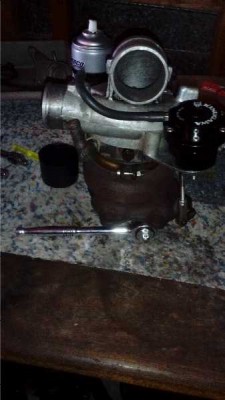

finally got round to putting the rebuild kit in the turbo and the new actuator turned up so it's all back together :D :D

I found the bend on the compressor housing a real pia when it came to hooking up the intake from the air box. Ended up just cutting it off and welding a bit of Ali pipe on then ground the inside out to thin the pipe wall.
then with a bit of heat and a big bar I rolled it to a bit of a bell mouth so it fitted the 3inch intake pipe. Also started to build boost bout 100rpm earlier.
Good thing about those turbos is both housings are easy to rotate to get things to line up. Esp to get oil inlet at the top

yeah, been umming and ahhing about that bend, will see if i can get away with it but if not i was thinking along those lines. if i rotate it do i have to notch the housing to sit over the locating pin or will the pin come out? couldn't pull it out when i had it apart
crazyclark31
Posts: 867
Location: invercargill.
Post by crazyclark31 »
I just pulled the pin out. Did have to mod the actuator mounting but is pretty easy to do.
Unless you ve got the air box behind the left battery I really recommend cutting the bend off , makes things soooo much easier. And way less bends in the system

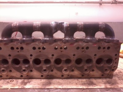

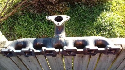

had a few spare mins today so managed to get a bit further with the exhaust manifold. owes me $130. still need to smooth out the welds around the inlet ports but came up quite nice. was going to get a bit more carried away with the collector but decided the gain wouldn't be enough to warrant it plus the port ended up quite a good size and has a kicker in the middle at the bottom forcing gas up towards it any way. next up is a dump pipe.

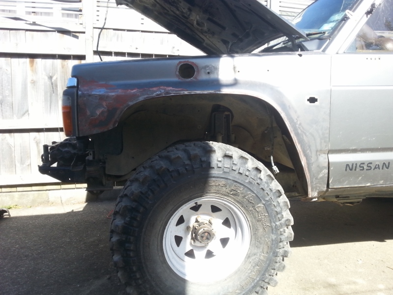

chopped the front guards up this weekend. Had the same issue i have when trimming a tree, start cutting and before you know it there is a lot more gone than you planned :? . Oh well plenty of room now :roll: welded a strip along the guard at 90 degrees to screw flares in to. got to attack the rear quarters and little bit off the rear guards now, shouldn't be a drama. starting to take shape now though.

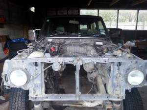

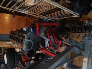

been chipping away at it, got the guards trimmed up,
did some testing before fitting the turbo and found it was way down on compression in one cylinder and the others were below min spec so decided i might as well give it a freshen up. also changing up the suspension to 3'' flexi springs all round and 4'' amada shocks cheers to trundles automotive.
y60 safari driver
Posts: 181
Joined: Thu Jul 08, 2010 6:33 pm

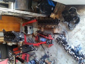

Post by y60 safari driver »
Stripped down to a bare block, found some big bits of metal in the sump now to track down where they have come from. One bit was cylinder twos piston skirt oil squirter. not sure what has caused that to break off. Let the investigation begin.
