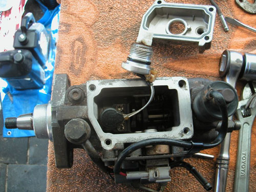

Photo from toyotasurf.asn.au
Also no bleeding was neededImage
