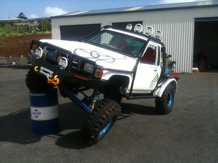

Hi Team, Interesting read. Just wondering if anyone could help me out out with the following. I am currently mating up an A340H auto to a Toyota 7MGE for my Hilux, have all of the wiring sorted except the transfer section. Any pointers or info ?
Cheers Brad
HYPERLUX
Cheers Brad

I have made one of them work. They are hydraulic shifted so you need the engine running to select 4wd, and there is a solenoid in there that needs to be powered when you move the lever to low range. The range select switch on the side of the transfer case can be used to get it working.
