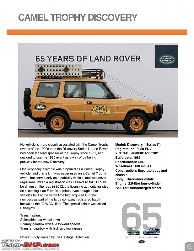

Post by Crash bandicoot »
muddyplumber wrote:The debate on weither or not the truck I have is actually an ex camel truck came up again when I was selling some bits the other day,I have been told its not and have been told it is by various Landrover nuts.
It may have been a support vechical....possibly.
It maybe an old shell that someone tried turning back into a camel look a like over the years.
I realise it has got bits on it that arnt the real deal etc. I have pulled the winch out and everywhere you look it's Sandglow,all mounts and body panels.Did they make a 1990 3 door Discovery that came out factory in Sandglow that wasn't intended for the Camel Trophy?
I'm just really interested to find out its history,the fella I'm dealing with at the mo is from the UK and reckons he will have an answer for me soon. On another note,I havnt welded anything to the chassie so in theory it could be converted back to Landrover diffs in the future.But for now will continue with the build. Rich
I have some news for you
I sent your pics to a mate in the UK, he came back with
"65th anniversary model, a limited pre production as a camel trophy but were not used in the event in any way as the competition ones were all made LHD."
lax2wlg
Posts: 1437
Location: Various areas
Re: 1990 2 door disco
Post by lax2wlg »
Technically impossible, its a 1990, the company has been around only since 1948.
Crash bandicoot
Posts: 2924
Location: Towing a hilux
lax2wlg wrote:Technically impossible, its a 1990, the company has been around only since 1948.
Checkmate 8)
before 1978 L/R was a division of British leyland.
That green one is Pre production which also means it's older thye actual main production model. possibly by another year or two.
