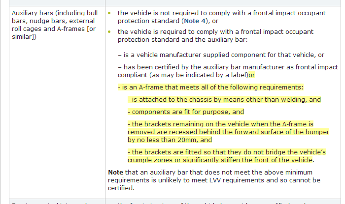

Re: Sliders- weld or bolt
Very interested in this one.
http://vehicleinspection.nzta.govt.nz/v ... tal-impact
Found this which may shed some light.
Item 2 & Item 3 under "MODIFICATION"

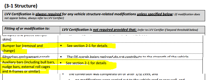

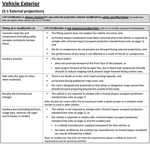

http://www.lvvta.org.nz/documents/stand ... Impact.pdf
I thought it was a structural issue, ie you are welding to a structural element.
Modifications that do not require certification
A vehicle is not required to be certified to the Low Volume Vehicle Code,
provided that the safe performance of the vehicle is not compromised,
where the only modifications to the vehicle are any one or more of the
following items:
(a) the fitment of additional cosmetic panels or accessories made from
fibreglass or other light-weight deformable materials; or
(b) the fitment of auxiliary lamps, provided that the lamps and their
fitment do not breach the general safety requirements of any
applicable safety-related legal requirements; or
(c) the fitment of auxiliary bars or racks, provided that the bars or
racks and their fitment do not breach any applicable safety-related
legal requirements.
http://www.lvvta.org.nz/documents/suple ... eshold.pdf
The picture above of (2-1 external projections) is the evidence.
Lvvta cert is required UNLESS SPECIFIED BELOW. then it goes on to say that for auxiliary bars if the vehicle is not required to meet frontal impact laws then it is sweet. You could have an external roll cage without a cert too if you wanted.
Edit: sorry, also read item 3 here http://vehicleinspection.nzta.govt.nz/v ... tal-impact
Where it says that a modification, including something welded to the chassis requires cert unless specified in the table, then it links to the table shown above.
